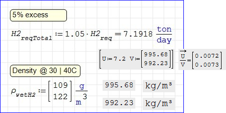

I have a figure that is mass flowrate & I have a matrix with x2 volumetric densities. I want to divide former with the latter to get x2 different volumetric flowrate. How should I proceed given I cannot simply put Matrix in divisor
Screenshot
https://prnt.sc/JVkxiL50fw46

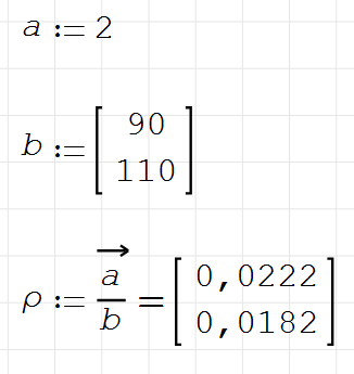

Use the "vectorize" function (you also find it in the right panel)

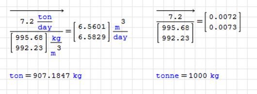

Please be very careful with this type of calculations with false units without any sense, as they can lead to fatal accidents.
#5 Posted: 4/10/2022 10:23:50 AM
Splendid remark ! because no project description.
As given T/day, add g/m³ of H2 at two different °C
#6 Posted: 4/10/2022 10:31:05 AM
579 likes in 1,348 posts.
Very nice and considerable advice.
Some so-called expert engineers can't even use units.
Expecting them to use correct and proper one is futile effort.

Thanks for the replies everyone...
Yes Ton / Tonne difference is important & I have corrected it in my calcs
