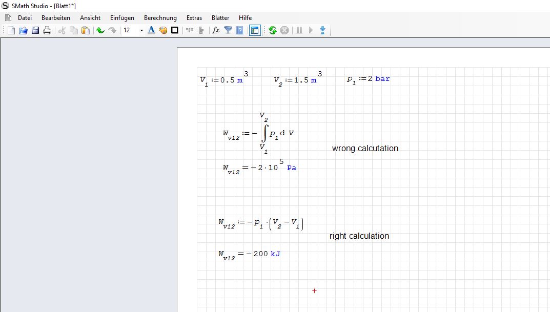

the Integration function doesnt seem to work in the right way.

1. Integration is over an integrand, here you have a constant
2. Squeeze the math regions, capture those regions to reduce the image
3. Doctoring is best with the work sheet.
... the Smath integration operator is Simpson.
id: it ranges from very accurate up to 15
and ranges from absolute crap !!!
That suggest the WS for doctoring.
