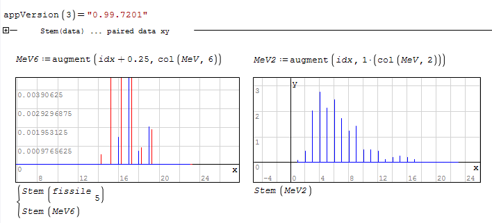

By same token, does it run correctly the Fission project ?
It failed previous SS 7109.

Andrey Ivashov 9/19/2019 4:02:00 AM

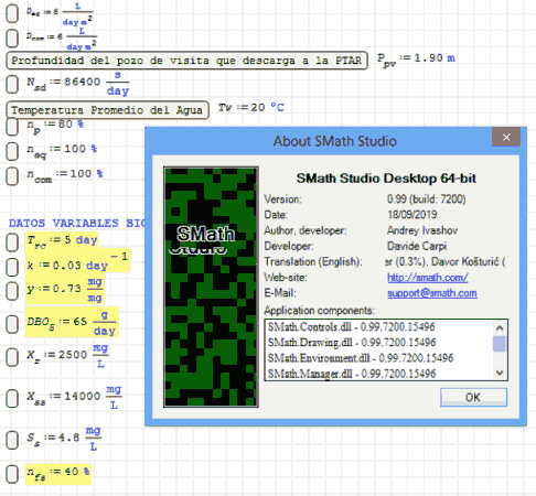

It seems that this new version of Smath Studio has several problems, for example sometimes
it omits showing the description of the variable.

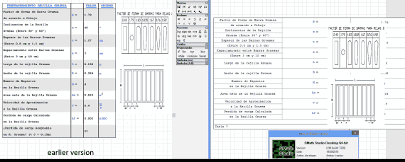

In the Tables, it does not respect the settings given in any previous version.
For now it is all that I have found, and I wonder, why in each new version, one thing is fixed and another is upset?
Thank you.

I too observe the Problem with Tables in 7200.
Additionally, Maple tools also failed.
Project Fission.sm (166.12 KiB) downloaded 1655 time(s).
Thank you! Fixed here: https://en.smath.com/forum/yaf_postsm59417_Beta--SMath-Studio-0-99-7201--19-September-2019.aspx
I will check Table Region today.

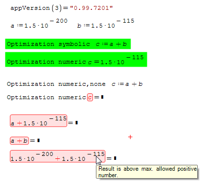

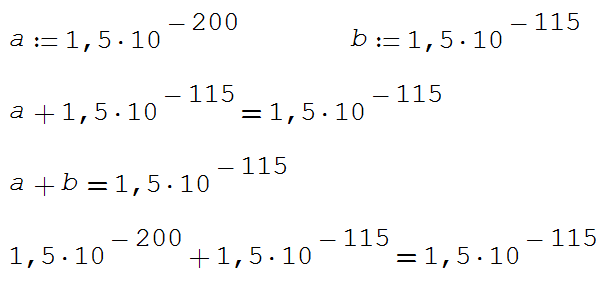

this problem triggered another one regarding the small numbers.
I am still quite puzzled with this. Especially when you are trying different optimizations???
Best Regards,
#9 Posted: 9/19/2019 1:15:57 PM
2,343 likes in 4,043 posts.
Best Regards,
This was fixed today. New version will be available in several hours.
I've checked TableRegion and see that it uses tag to store data which is restricted as SMath Studio uses this tag for its own purposes. I've implemented a workaround to the logic of opening files to allow TableRegion work with tag but I can't guarantee that this workaround will continue working in future releases. So, it is pretty important to switch plug-in to use another tag name for its purposes.

BTW Carlos: Fission is OK or red like 7109 ?
Hello Jean
Fision is Ok also in 7202
Carlos
Hello Andrey
Thank you very much, now, the function Show description and Table, work very well in version 7202
