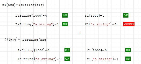

I found this bug defining user functions with IsString()
The issue disappear using IsString inside line()
regards,
w3b5urf3r

I'm not sure whether this is a bug or a delayed-evaluation 'feature' of using/not-using the program line. I raised a similar question about a month ago ...

#3 Posted: 7/29/2012 2:55:10 PM
2,343 likes in 4,043 posts.
Thank you! Fixed.
Regards.
