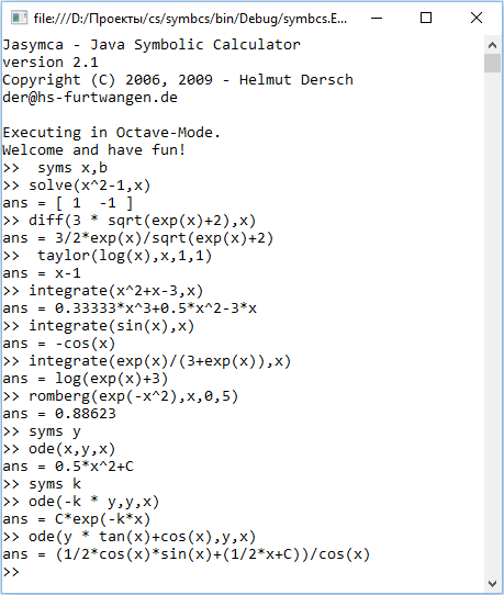

Updated ( github ).
The project can be compiled, but still does not work as expected.
#7 Posted: 2/8/2019 11:14:39 AM
1402 likes in 1708 posts.

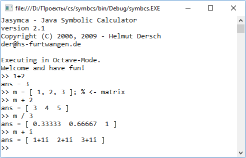

Simple calculations now work.

More functions.

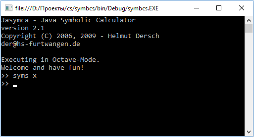

Binaries added to the repository.
exit + [ENTER] or [Ctrl] + [c] - Exit.
