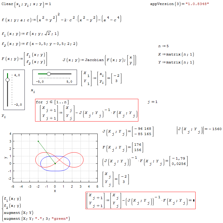

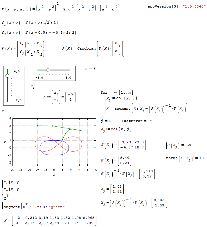

#2 Posted: 4/9/2023 8:56:19 AM
Very nice.
I had problems when reproducing your 2D version. Depending on initial guess I got errors "requested matrix element does not exist". The situation seemed to improve a little by pre-allocating the vectors X and Y yet it didn't become really robust.
So instead of assigning to j+1 elements I used augment() to add new points to the iteration history.
This is the original version:
Newton2D.sm (21.4 KiB) downloaded 1472 time(s).
And this is the modified version.
Newton2Da.sm (19.03 KiB) downloaded 1599 time(s).

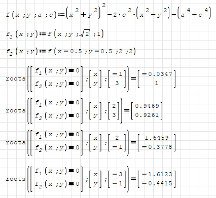

#3 Posted: 4/9/2023 2:27:18 PM
... can't find 2nd root
2nd root confirmed exact.
Solve(f,q,x0,x1,TOL) Copy.sm (162.62 KiB) downloaded 1587 time(s).

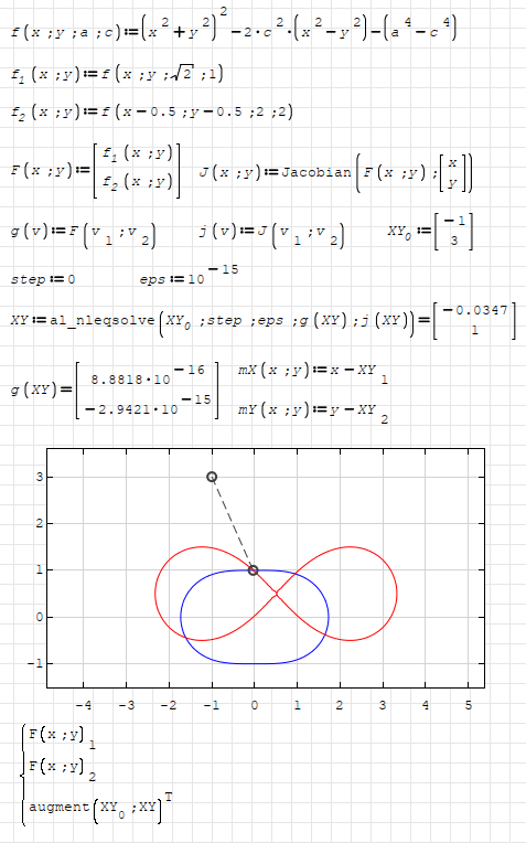

#4 Posted: 4/9/2023 2:33:35 PM
598 likes in 1,380 posts.
Tried to solve your functions with al_nleqsolve().
Newton.sm (13.85 KiB) downloaded 1513 time(s).

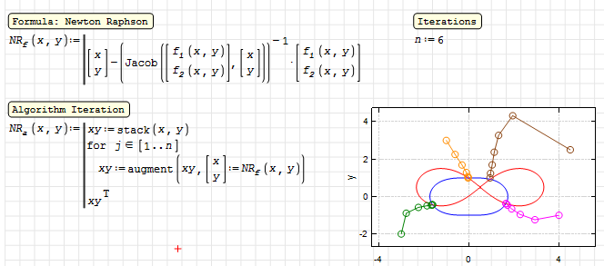

#5 Posted: 4/9/2023 6:19:38 PM
Another way, keeping the mathematical formulation and the iteration algorithm separate. As here.
Newton2Da.sm (13.34 KiB) downloaded 1630 time(s).

#7 Posted: 4/10/2023 4:21:38 PM
I cannot use the roots function
Actually, you can.
