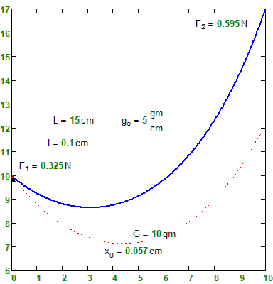

I finally took a ride along this road with my granddaughter. On the way, I was not thinking about the beauty of Moscow, but about how to solve this problem at SMath.

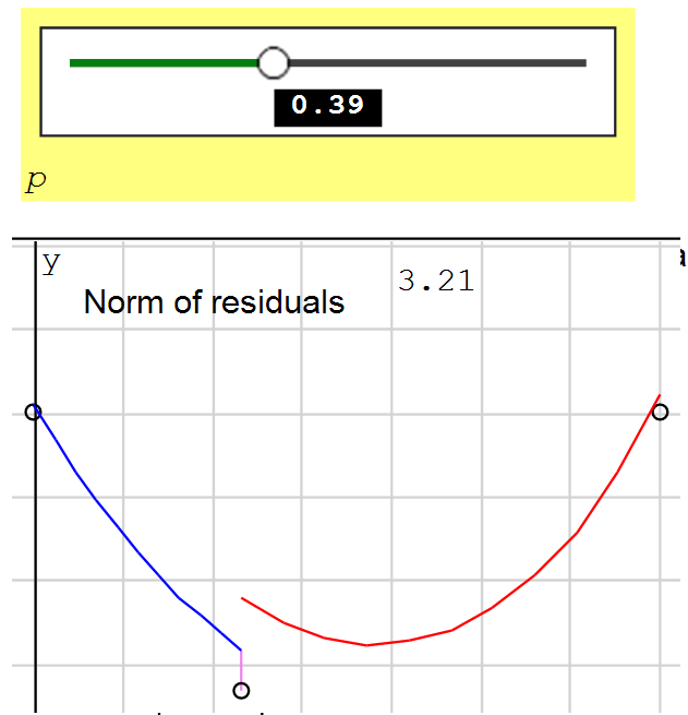

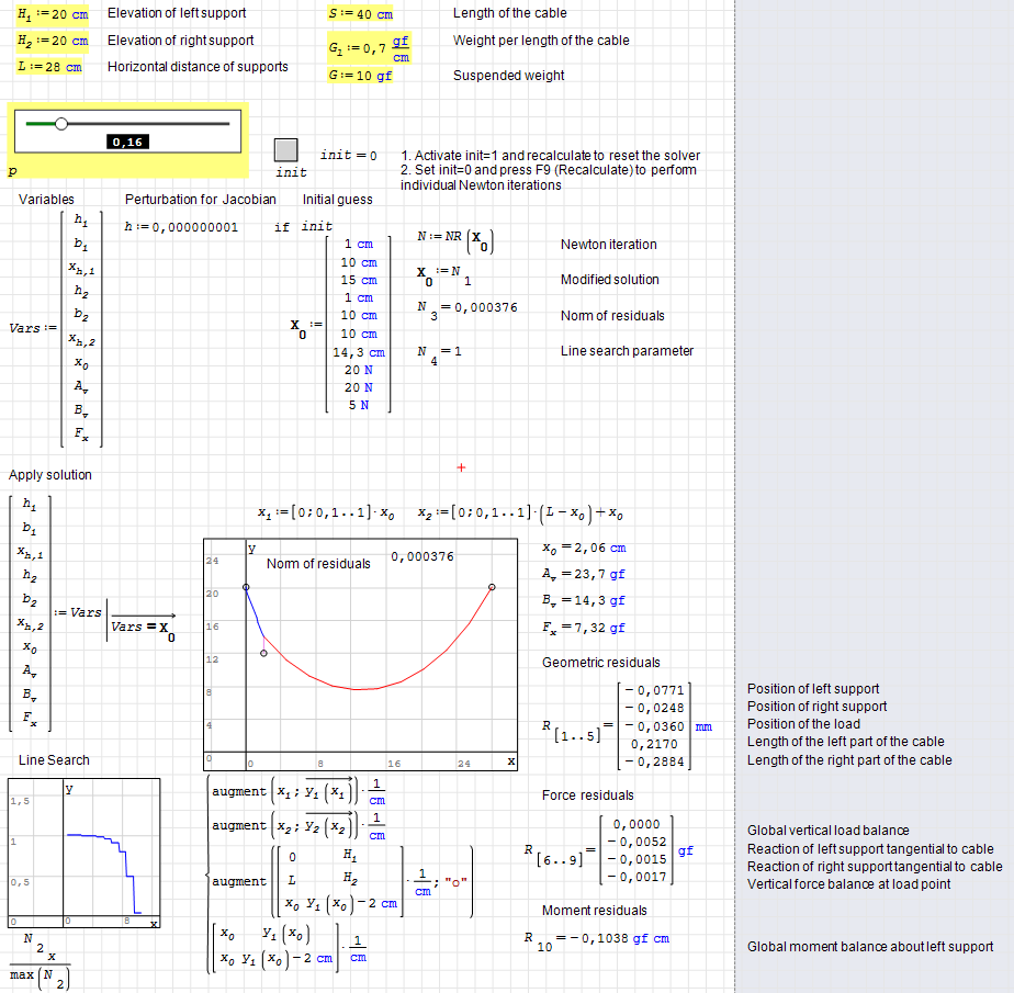

#4 Posted: 4/16/2024 6:01:25 AM
This solution is not really animated but has a slider to change the position of the suspended load.
The solution is unreliable at the endpoints. The procedure is Newton-Raphson with approximated gradient.
Each new iteration uses the result of the previous one as initial guess. This is done using absolute variables. Just follow the instructions to properly initialize the procedure.

Yes, that is dependent on how fast you move the slider, small steps usually produce good solutions. Note that the procedure just performs a single Newton iteration. To improve the solution, press F9 (recalculate). I forgot to mention this. Yet, this still does not always work.

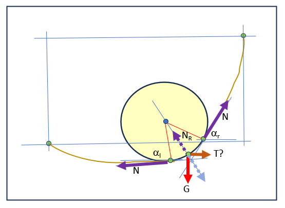

Hi Valery, Hi Everybody,
I think that it could be possible to deal with the problem as a structural equilibrium one, using a FEM technique. The drawing and the animation are details after having the right results.
It seems that the rope is considered as inextensible; an approximation not always accepted.
The proposed dimensions let us think more to a sort of toy than to a technical object as that from the photo.
However, this does not represent a too high difficulty for looking for a solution. In fact, for each X given abscissa value, there is to obtain the Y ordinate value for the nacelle position. In each (X;Y) nacelle position, the force’s equilibrium must be assured. This is the way to determine the Y for each given X. The traction rope must assure the missing force to fix the nacelle in a position. Without knowing the traction rope data, the problem is not enough defined (?).
Another variable could be the length of one of the two segments of the cable...
If I understand, the proposed problem includes some input features and data as:
• A unique nacelle rolling with a pulley on the carrying rope (???) : G=10 g.
• A carrying rope : dX = 10cm; dY = 7cm; L = 15cm; gc = 5g/cm; Gc = 15cm x 5g/cm = 75g.
• A traction rope: undefined as geometry and its end support positions. (???) Its behavior is unclear for me …
An equillibrium possibility:
Best regards,
Ioan

In the given system there is no traction rope. There is a single rope which runs in an endless loop. There are several ways to parametrize the system. You can use the cable length on either side of the nacelle, or as I did, the fraction of the total length.

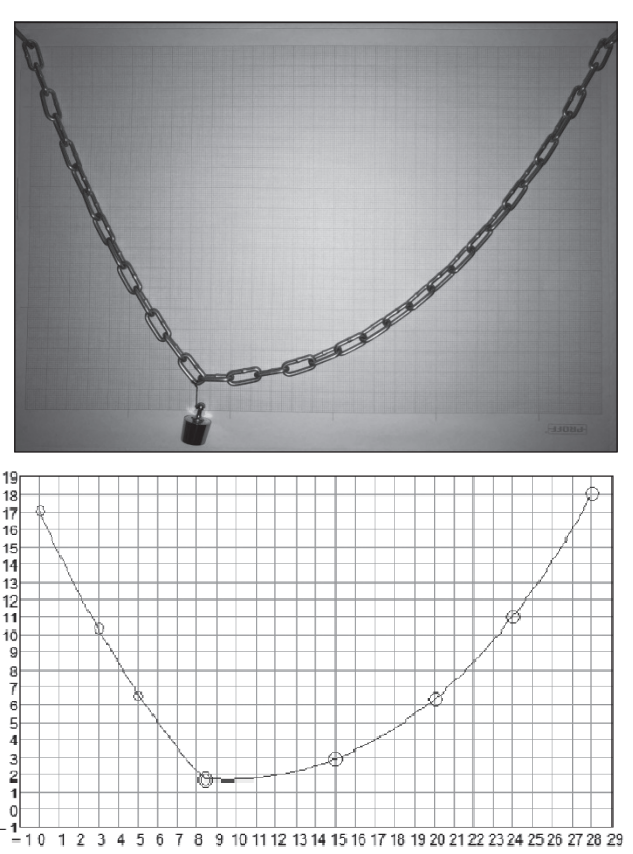

My students solve this problem at the intersection of mathematics, mechanics and computer science (STEM education - see
https://www.routledge.com/25-Problems-for-STEM-Education/Ochkov/p/book/9781032174624).
We take an inextensible cable of length L and with a known specific gravity (the mass of one meter of cable). We attach a load of known mass to this cable at a distance l from one end of the cable. Next, the cable with the load is attached at two points. It is necessary to determine the geometry of the cable sag and the force at the attachment points. Then you need to change the value of l from zero to L and create an animation.
I can do this in Mathcad, but I cannot do it in SMath. I turned to you for help.

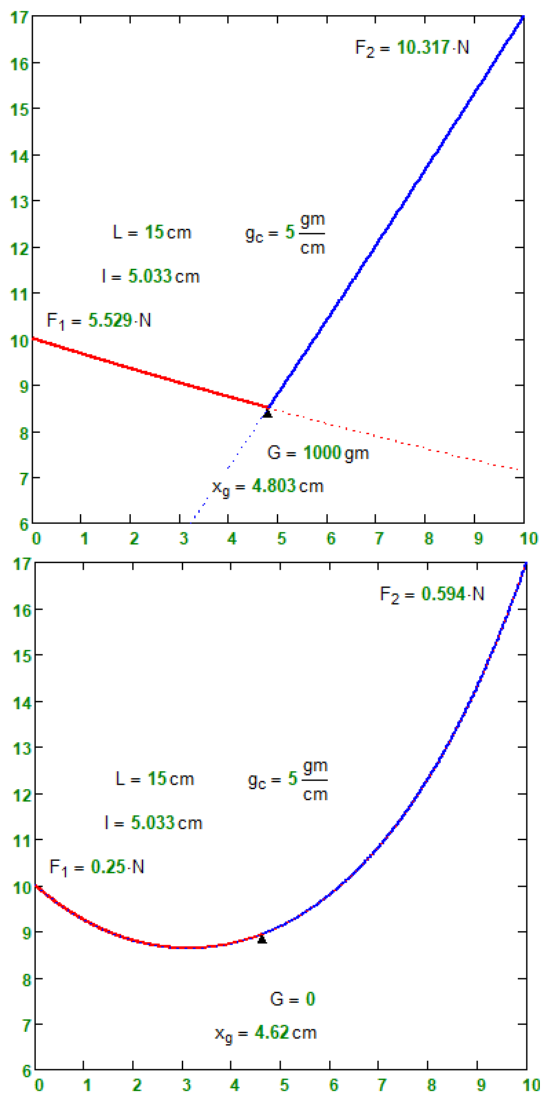

#12 Posted: 4/20/2024 4:33:14 PM
Valery Ochkov
Valery Ochkov
66 likes in 697 posts.
The dotted lines are a phantom continuation of the catenary.
If G=0 we have one line.
#13 Posted: 4/20/2024 4:48:57 PM
If the cable is fixed on its two ends, "the phantom" must be a cosh curve passing through this 2 same points ??? !!!

Here is my force-balance approach to this problem.
I divide the cable weight into a number of nodes equally distributed along the cable, then add the cable car weight to one of the nodes (the one nearest to the distance that it was added in the original catenary file here, though this can be changed as desired). The nodes are then assumed to be connected by weightless, inextensible links.
It took me some time to get the syntax right! I’ve no doubt an SMath expert could significantly improve the implementation.
CableCar.sm (44.09 KiB) downloaded 1474 time(s).

See please Figures in my article
http://twt.mpei.ac.ru/ochkov/Chain.pdf

See please Figures in this article too
http://twt.mpei.ac.ru/ochkov/catenary.pdf
