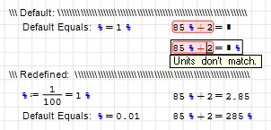

I am curious about the operation of the percent "%" symbol.
If I add, for example, 1+100%=..., it gives the warning "units don't match".
I would expect it to return either 2 or 200%.
I only installed the program a few days ago, so maybe I am misunderstanding the operation of the % symbol. The program is very nice - just trying to figure out the details for input, etc.

To the best of my knowledge, you should be able to redefine the 「%」 from 「dimensionless」 to a 「number」 of value: 0.01; keypress the following at the top of your worksheet:
'%:1/100
(NOTE: I currently have the settings.inf file modified to Imperial units 「OutputUnitsSystem=Imperial」 and % appears to behave as expected when it is redefined to 0.01)
-Kenny Lemens, P.E.
