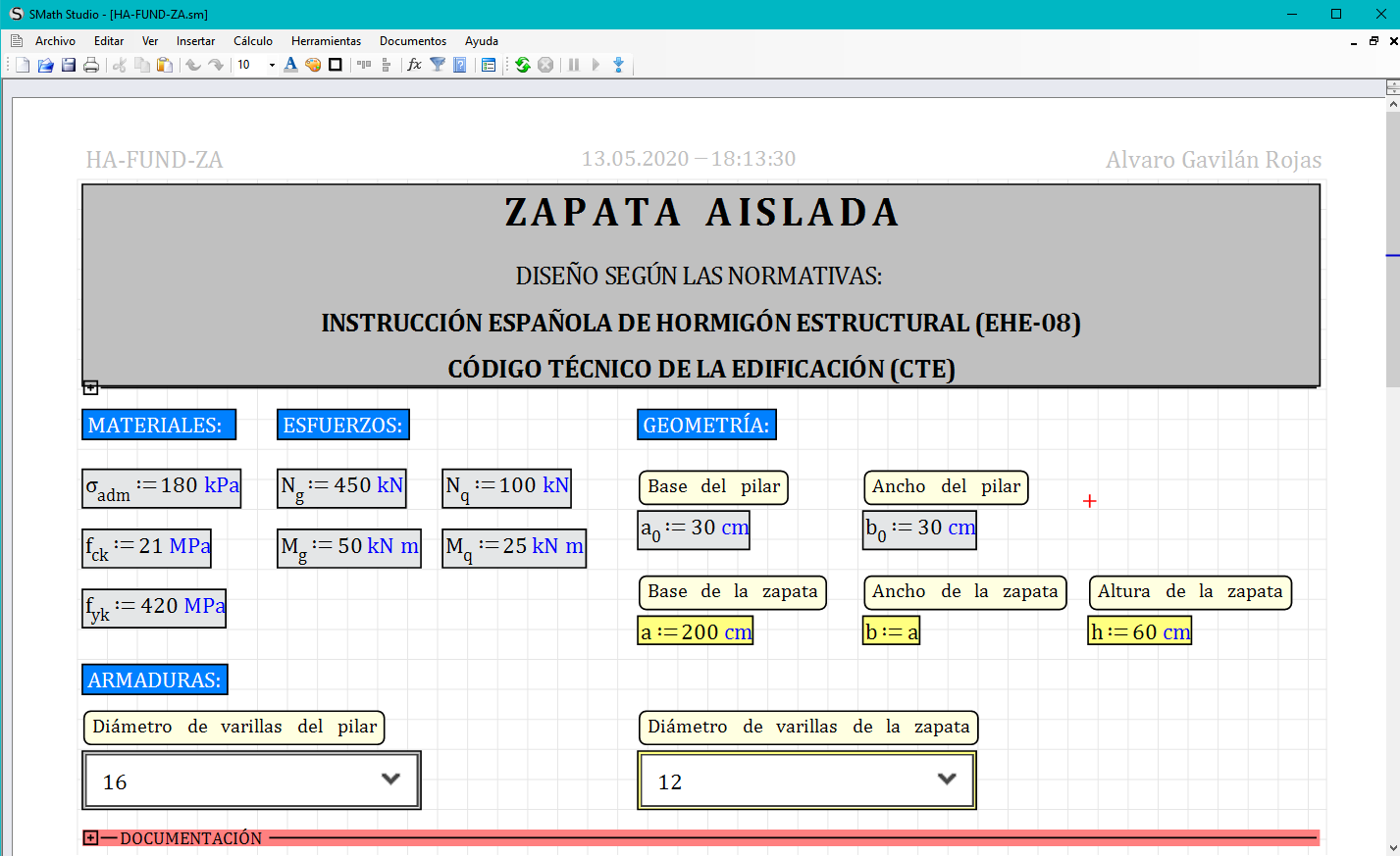

SMath capture:

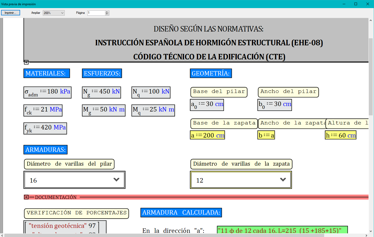

Print preview capture:

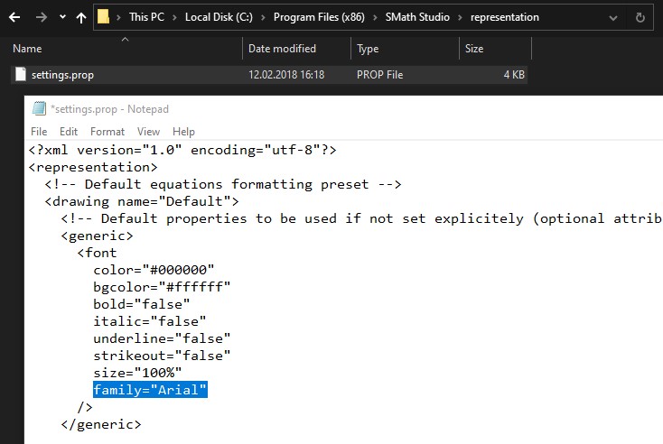

could be restored the capability of changing this by modifing the code in the file setting.prop?
I've checked modification of settings.prop and it works well.

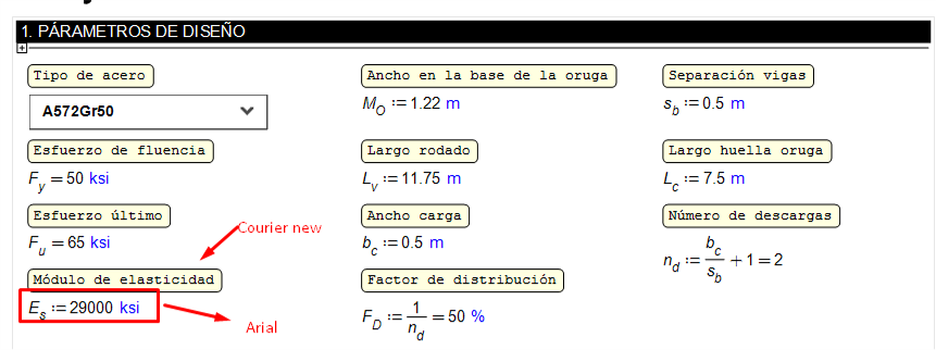

Sorry Andrey, I was not completely accurate. The problem is that now the description text do not change to arial and still on courier new when you change the settings.prop file. Please see the picutre below:

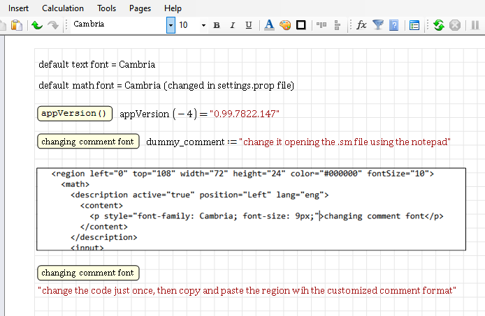

As a workaround that could help you, Melo15, I attach here an image that could be useful. Saludos!
Hope it helps!
test comment.sm (14.58 KiB) downloaded 1309 time(s).
