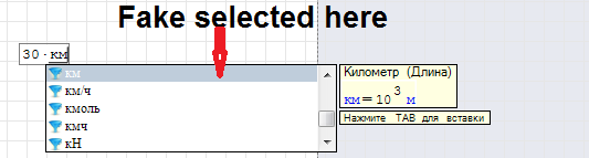

This is very old issue and i guiss its enough 1 row of code to fix it
the issue is following
For example,
i type "30" then type "км", get dropped listbox, then push enter. so i got км - неопределено
Then
i type "30" then type "км", get dropped listbox, then push arrowdown, then push arrowup, then push enter. so i got normal blue kilometers
#2 Posted: 5/22/2021 1:53:56 PM
2,315 likes in 3,937 posts.
This is by design.
By default Enter means "leave focus from region". But when you starting to work with suggestions list explicitly meaning of the Enter button changed to help you make a selection.
#3 Posted: 5/22/2021 3:48:56 PM
ur_naz
ur_naz
0 likes in 15 posts.
Then list_box is dropped, zero item is seems to be selected. so if i leave entering enter, i expect my choice should been applied.
Anyway, what is the difference between "км" and "км" as dimension?
And why various items of list_box requires various actions: double-click on zero item and push arrow buttons for the rest items (much more comfortable, because i have not grab the mouse and double-click on item already chosen)
#4 Posted: 5/22/2021 4:47:28 PM
To use selected item you just need to press Tab. Enter is to leave a focus from Region.
#5 Posted: 5/22/2021 7:19:06 PM
ur_naz
ur_naz
it is very inconvenient when buttons are redefined in an unusual way because muscle memory is shaped according to patterns used in other more traditional applications, which are used much more often. Therefore, a desire automatically arises to press Enter, despite the prompt to press Tab. Moreover, the Tab button is much smaller and is located on the left, that is, on the side of the weak hand. For me, for example, it is much easier, more convenient and faster to press the down arrow, up arrow and Enter than to look for the tab button on the keyboard.
Finally, if you type 30km, then down arrow right arrow, what should happen? I think nothing should happen, but there is a loss of focus and an undefined value of km. What if I just type "30 km ="? I get km - undefined. Why do I have to choose from the list every time I enter a dimension ???
In general, to be honest, because of this small oversight, all my impression of the program as a whole is blurred.
By the way, I took 4 random IDEs that support auto-completion. In two of them the tab button did not work at all, in two it worked the same way as Enter. For example, in SharpDevelop, the tab button works like Esc, because the zero element is not selected. but if you select any item, then it works like an Enter. Because the Enter button is usually used to execute the default function and not to "leave focus from region". Just the Tab button shifts the focus to another control.

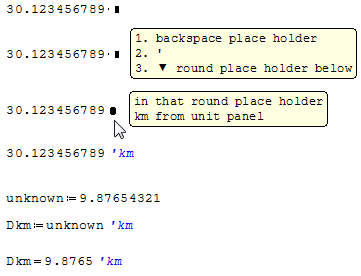

#7 Posted: 5/23/2021 12:21:01 AM
Alvaro Diaz Falconi
Alvaro Diaz Falconi
1,076 likes in 1,748 posts.
... What if I just type "30 km ="? I get km - undefined. Why do I have to choose from the list every time I enter a dimension ???
Just because you want. You can choose to directly type "30'km="
(Notice the ' character)

#11 Posted: 5/23/2021 6:40:21 PM
Sorry, no recollection of that issue.
Can you have other issue than 30.123456789876543210 km ?

#14 Posted: 6/13/2021 11:29:11 AM
I want to get the result w/o using mouse or any other pointer. just keyboard

#16 Posted: 6/14/2021 5:46:43 PM
Скорость:=30км[Enter][arrow_right]/10мин= #fist item seems to be already selected, but in fact not
Interesting thought actually. It seems I need either to:
  1. show selection only if written text is exactly the same as shown in the list;
  2. replace written text with the one selected in the list as soon as list is closed (even if no Tab or Enter pressed).
Seems reasonable, I will handle it soon.
