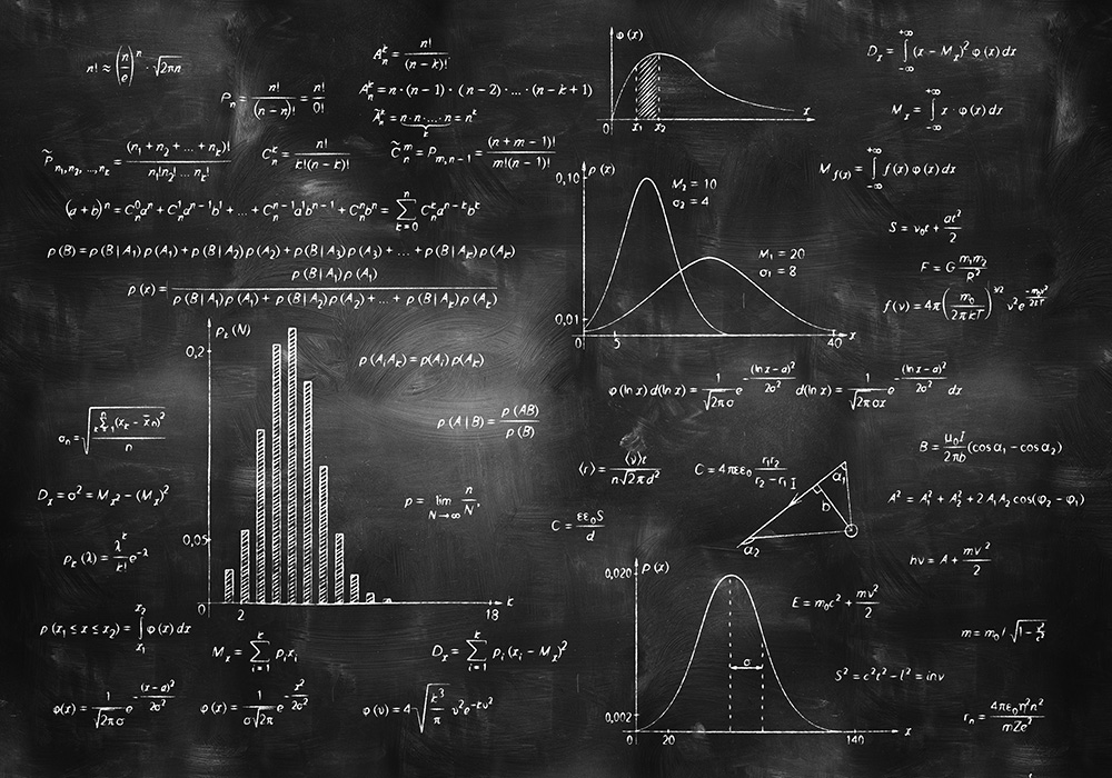

#5 Posted: 12/7/2021 12:01:36 PM
The Question: Is there a Dark Mode and if where do I click to get it?
Is that what you mean by Dark Mode ?
#6 Posted: 12/7/2021 1:02:38 PM
1,554 likes in 1,864 posts.
sergio 12/7/2021 1:22:00 PM, Davide Carpi 12/7/2021 3:00:00 PM
#7 Posted: 12/7/2021 2:03:32 PM
Sorry, I won't dare publish that f...n crap !
#8 Posted: 12/7/2021 3:10:14 PM
1,443 likes in 2,935 posts.
Dark/Night mode usually is intended for editing, not for publishing. While activated, what is printed black-on-white is rendered white-on-black on the screen. It become a little bit trickier to handle when colors are involved, since lighter color looks better on the "virtual" (dark) background but not always on the (white) paper... like in Autocad when you have a layout view on white background while the drawing is made on the classic black canvas...
However as long as something it is optional, nothing wrong to me. There are plenty of presentations made on dark backgrounds, and are often more readable on screen/live projection than the white ones. A pain to print and read on paper? Absolutely.
