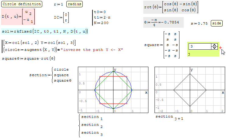

Let's say I create a radio button list to set the geometry of a cross-section to be Rectangular or Circular.
If I choose Circular, I only have to inform (via slider) it's diameter.
If I choose Rectangular, I have to inform a width and a depth.
In the latter, is it possible to set the creation of the second slider dependent on my radio button input?

... as you can see: up/dn counter and slider don't save settings.
They have, both from canvas and from dialog. So yes, it is possible to elaboratesome degree of automation based on the inputs. If the roads are too different probably would be better to use collapsed areas with backed layouts however.

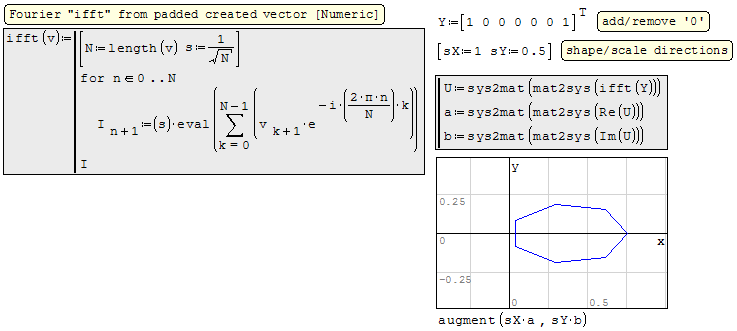

... add odd/even/shaped polygons.
