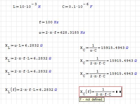

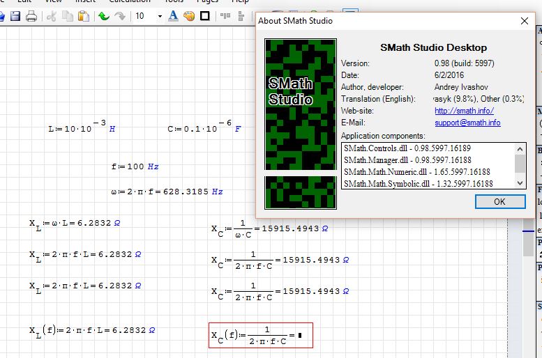

I am getting the following:

#2 Posted: 6/24/2016 9:39:49 PM
Hi Basile.
That's is the expected way to work with smath.
To get the value of X.C you must to call the function after defining X.C with X.C(f)=

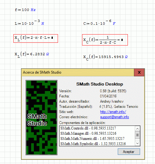

Depending which version, it could be. I guess that must to be an election from author, this is, if eval functions in that way. The "not evaluation" option, as the attached picture, it's ok for me.

i am using

#12 Posted: 6/26/2016 1:03:00 AM
Alvaro,
You are confusing things.
What you say are correct but have to do nothing to do with the question.
X.L, X.C are reactance (with j or without j)
Z is impedance of R and X.
Basile
Hi Basile. I don't confusing. Reactances ( https://en.wikipedia.org/wiki/Electrical_reactance ) are reals and impedances ( https://en.wikipedia.org/wiki/Electrical_impedance ) are complexes. So X.L, X.C can't have j.
About the numerical evaluation for a function, check this old post: http://en.smath.info/forum/yaf_postst640_Function-as-a-program.aspx
In X.L, X.C definitions as functions, f must to be a local variable. X.L(f) -> (symb evaluation) must to set the answer with "f", not with "100 Hz". And the numerical evaluation X.L(f) = must to be in red, as f as local variable isn't defined.
As a choice of the program writer, and what you can see in the last post of the above referenced, you can set all the local variables as globals with f(x) = 1*(line ... ). Actually I'm not comfortable with that behavoir, but is the choice of Andrei.

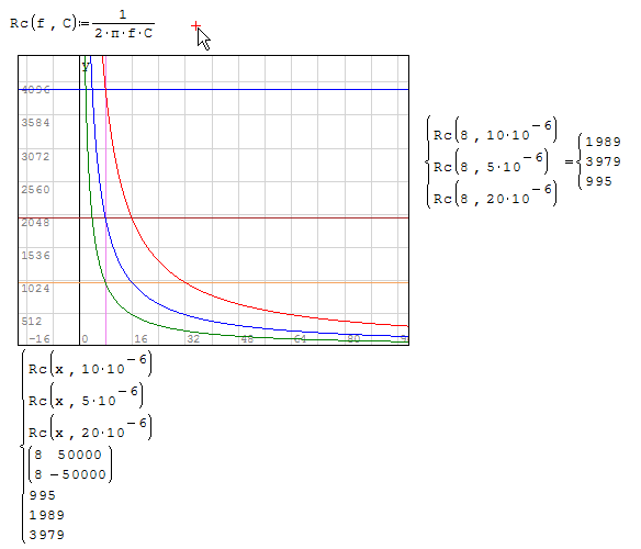

#13 Posted: 6/26/2016 2:01:29 AM
Just like this Basile, for a family of "C's"
at a fixed frequency 8 the magenta line.
On the plot, 'f' => 'x'.

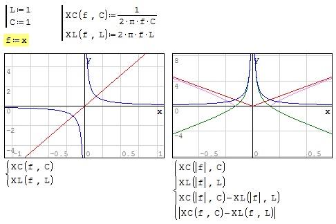

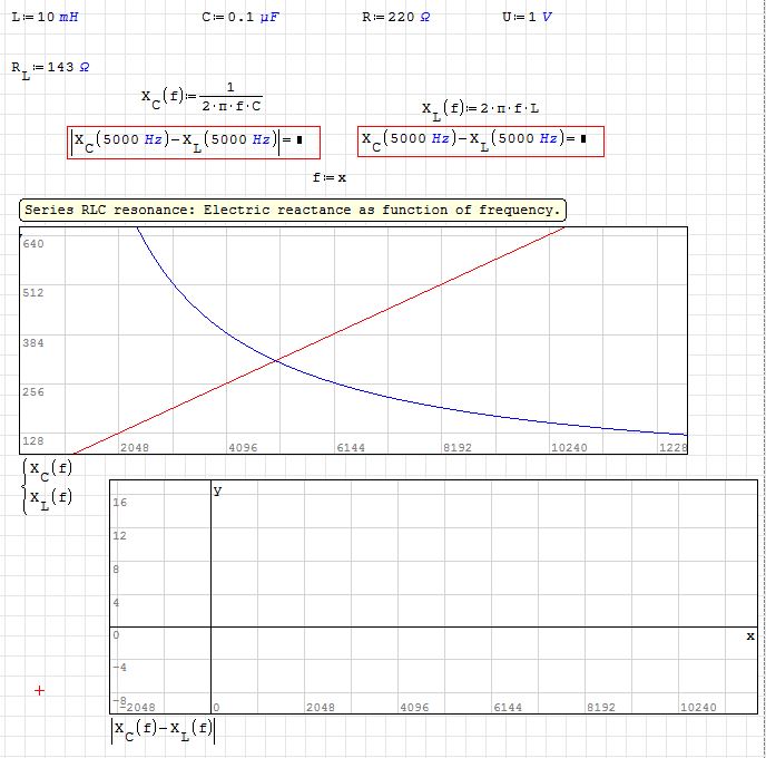

#14 Posted: 6/26/2016 2:59:10 PM
Basile
Basile
8 likes in 172 posts.
Jean,
Yes, I can plot X.C(f) and X.L(f) but if I try to plot the difference or take the aritmetic difference does not work.
Please see figure and figure in post #1 on top, if it helps.

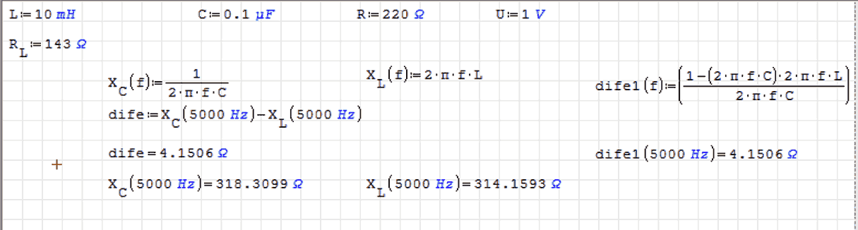

#20 Posted: 6/27/2016 1:54:29 PM
CBG
CBG
78 likes in 312 posts.
Redefining subtraction or function.
Carlos
test resonance_CBG.sm (10.1 KiB) downloaded 1120 time(s).
