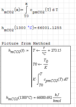

Hi, I have a question about calculation of definite integrals with integral variable in the upper boundary. See example file. Is there any possibility to calculate this integral in Smath?
Best regradsEnthalpy_CO2.sm (12.63 KiB) downloaded 1262 time(s).

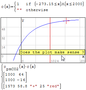

Observe correction in red.
More generally "integrate_0000 [Introduction Scalar]
Enthalpy_CO2.sm (12.12 KiB) downloaded 1202 time(s).
Integrate_0000 [ Introduction Scalar].sm (36.99 KiB) downloaded 985 time(s).
