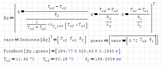

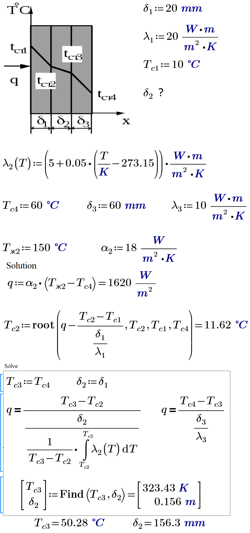

I can it solve in Mathcad - see please mcdx and pdf files
I try solve it (heat transfer) in SMath - see sm file

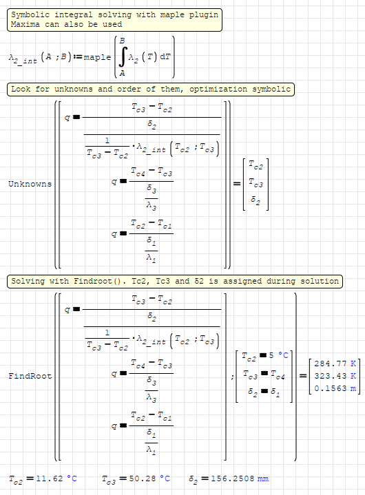

Help please
SMath symbolic solving of integration is not capable as Mathcad.
Thus integrals can't be used with numeric solvers.
However, you can use a little trick to solve them.
Using maple or maxima plugins is the key.
Here is your problem solved with various ways, roots() and Findroot().
solvewithunits.sm (23.4 KiB) downloaded 1228 time(s).

Hi. The attached have an al_nleqsol wrapper for a Mathcad block with units, that can accept SMath's integrals too.

#4 Posted: 6/4/2023 10:00:56 AM
598 likes in 1,379 posts.
Actually, you don't need to find Tc2 first hand.
Findroot() can solve with all three equations at once.
All important is the order of unknowns.
Valery Ochkov 6/4/2023 12:03:00 PM, sergio 6/4/2023 1:48:00 PM

Here is a paper-friendly version.
Also check how variable guess points are assigned.

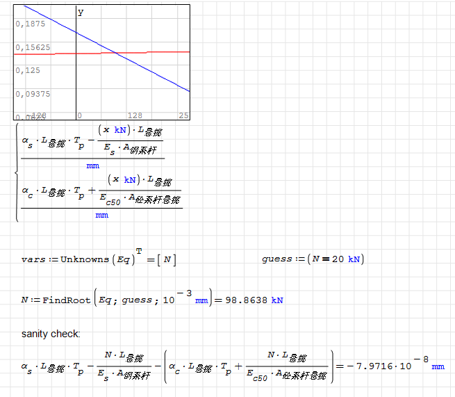

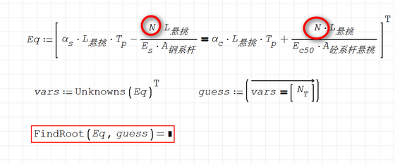

Please help, why can't find root for this simple equation?
root.sm (20.2 KiB) downloaded 1199 time(s).
Because there aren't unknows

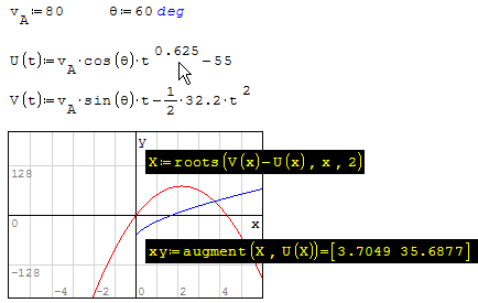

#11 Posted: 6/26/2023 8:45:01 AM
Please help,
why can't find root for this simple equation ?
roots solves wrt scalar function(s)
In this example, both functions are scalar wrt 'x'.
Try ... roots[(sin(x)-Gamma(x),x,1]
'x not defined' ... Gamma(x) is not scalar wrt 'x'
Few more numerical functions are not scalar
erf(x), erf(x,n) ... erfc(x), erfc(x,n) ...
#12 Posted: 6/26/2023 8:55:02 AM
In that case and similar ones,
RootSecant algorithm will spits out 15 decimals, instantaneous.
Cheers ... Jean.

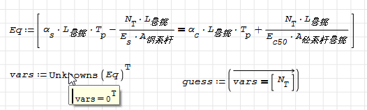

#13 Posted: 6/26/2023 10:06:59 AM
netsonicyxf
netsonicyxf
2 likes in 79 posts.
Thanks Davide.
Now I put "N" as unknown in the Eq. But it can't be solved either.
root.sm (19.41 KiB) downloaded 1180 time(s).
#14 Posted: 6/26/2023 10:58:58 AM
1,443 likes in 2,935 posts.
You have to play a little with the precision, especially if there are units involved; in this case, seems that 10^-3 mm is a stable target (10^-2 works too, but in some case it returns the guess value, meaning that is "close enough" for the algorithm - you can see in the plot that 0kN to 200kN is in +0.02/-0.02mm range)
root_r1.sm (24.03 KiB) downloaded 1224 time(s).
