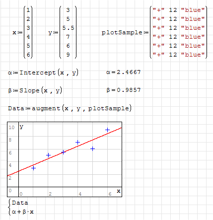

Intercept("1:matrix", "2:matrix") - Returns the intercept of the straight line given by a simple linear regression from a data points "1:matrix","2:matrix".
Slope("1:matrix", "2:matrix") - Returns the slope of the straight line given by a simple linear regression from a data points "1:matrix","2:matrix".

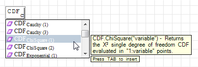

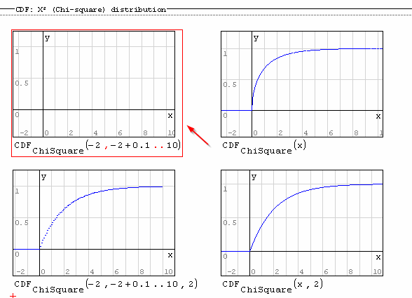

CDF.ChiSquare("variable") - Returns the Χ² single degree of freedom CDF evaluated in "1:variable" points.
CDF.ChiSquare("1:variable", "2:number") - Returns the Χ² CDF evaluated in "1:variable" points, using assigned "2:number" degrees of freedom.

I would kindly ask you to insert into this plugin at least intercept(x,y) and slope(x,y) functions for calculating the least square intercept and slope of a straight line giving two data vectors.
WroteHello w3b5urf3r,
Ok :d .

![SMath Studio - [sample estimators.sm].png](/en-US/files/Download/Z7mMpv/SMath-Studio---[sample-estimators.sm].png)
- added more tools: Regularized Beta function, Regularized Gamma functions (P and Q), Ceil, Floor, error function, inverse error function;
- added more estimators: Kurtosis, Kurtosis Excess, Moment, Skewness, Intercept, Slope;
- added more probability distributions: Student's t, Fisher-Snedecor, Chi-squared, Cauchy;
- added quantiles (all distributions except Student's t, Fisher-Snedecor and Chi-squared).
best regards,
w3b5urf3r
Many thanks for this plugin
Just played a bit, and have seen a problem with CDF.ChiSquare( "variable" )-(image attached). Did not quite understand why this problem appear at the moment. Also, do not quite understand what this description mean
CDF.ChiSquare( "variable" ) - Returns the Χ² sDOF CDF evaluated in "1:variable" points.
I suppose that sDOF means "single degree of freedom"

:d seem that some eval() in the Reguarized Gamma functions it's stricly necessary for some value.... fixed and updated
You supposed right :-p Now I've extended the acronym
EDIT: plugin updated again (Mean and StdDev names)
regards,
w3b5urf3r
![SMath Studio - [Page1].png](/en-US/files/Download/qBUdK8/SMath-Studio---[Page1].png)
