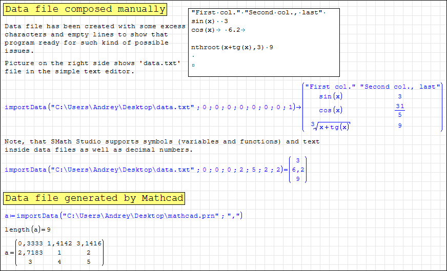

#5 Posted: 7/18/2010 11:06:03 AM
2,340 likes in 4,041 posts.
importData(..) created especially to handle Mathcad output data files, they have spaces or tabs as column delimiters and dots as decimal symbols. The final realization of this function like you can found in SMath Studio 0.88 was a bit changed for these purposes, so the screenshot from http://en.smath.info/forum/default.aspx?g=posts&t=372 is obsolete now. In your test you need to specify the last argument of the importData function as 1 - which means that data is symbolic (Mathcad doesn't support such data export). Maybe separators should be specified also.
Here is updated pic.

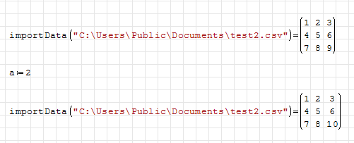

Andrey,
I notice a peculiar behavior of importData. I'm not sure if it's what you intended.
The first import function produces the results shown. I then introduce a variable a. I then duplicate the import function. Then I went and edited the file test2.csv. I came back to SMath and changed the value of a. The second import statement now shows the new values from the file. Notice the lower right hand value in each matrix.
This exercise was intended to show that each time something above the import function is changed the import function reruns. Maybe not something you want to have done for speed and efficiency. Any way to prevent a function from rerunning?
Ed
#8 Posted: 7/18/2010 3:37:33 PM
It is standard behavior of all math regions of the program. importData(..) function have no chance to save the data. After the data file is changed user should press F9 keyboard button itself to actualize the worksheet.
Actually this is by design. To prove the importance of such kind of SMath Studio behavior just imagine if your file will contain "a" parameter instead of last matrix item value. Then SMath Studio really needs to import the file first and try to substitute previously defined "a" into the matrix. Now imagine that you will change the value of "a" in definition (as you done in your exercise) - program should reevaluate the region(s) below to substitute "a" to the matrix again, but program have no initial matrix from file stored... it should be imported again. And of course SMath Studio has no idea if data from file contains any parameters or not - to check it program should repeat evaluation.
Hope I make it clear now
Regards, Andrey Ivashov.

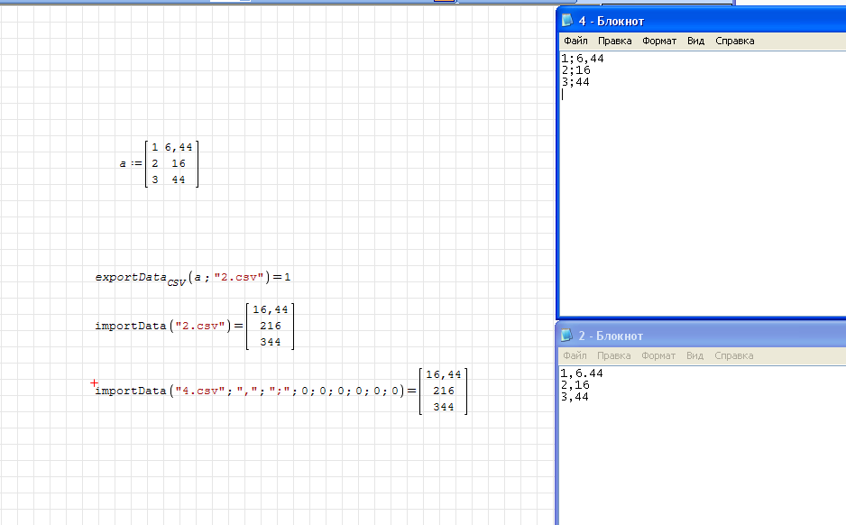

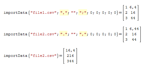

Hello
Help with Importdate (9)
I want to upload a matrix for the graph in smath. I use the format tsv. I use ";" as a separator. Decimal symbol ",".
What am I doing wrong with import date (9)?
Why I export a matrix with two columns
And I import with one column?
What is the best way to use to import data?
#14 Posted: 11/20/2019 1:07:53 PM
1,443 likes in 2,935 posts.
for numerical import, the 2nd and 4th arguments are those you have to set.
importData is a general purpose import function, hence can import even SMath studio data; 2nd and 3rd are decimal symbol and arguments separator "of single entries" (like in SMath Studio settings), 4th argument is the column separator of CSV data.
