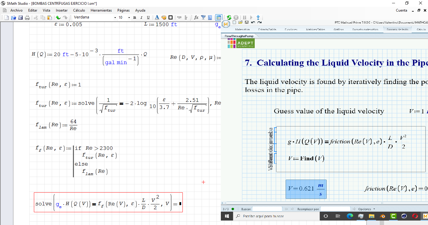

hi guys it's me again xD
There is an exercise to find the discharge speed of a pump in Mathcad Prime ... when I try to do it in SMath Studio I am unsuccessful
Resolving functions based on other functions in SMath Studio - Mathcad Prime
I leave the pdf of Mathcad Prime and the SM File
Liquid Flow Through a Pump.sm (42.2 KiB) downloaded 1060 time(s).
FlowThroughaPump.pdf (690.73 KiB) downloaded 711 time(s).

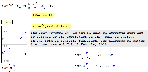

#2 Posted: 10/2/2021 1:55:16 AM
It didn't seem that difficult. Attached as far as I could advance.
Liquid Flow Through a Pump.sm (46.99 KiB) downloaded 1038 time(s).

#4 Posted: 10/3/2021 8:42:55 PM
#5 Posted: 10/4/2021 1:48:53 AM
Hi. Solved.
Liquid Flow Through a Pump.sm (51.06 KiB) downloaded 1067 time(s).
Liquid Flow Through a Pump.pdf (126.32 KiB) downloaded 655 time(s).
