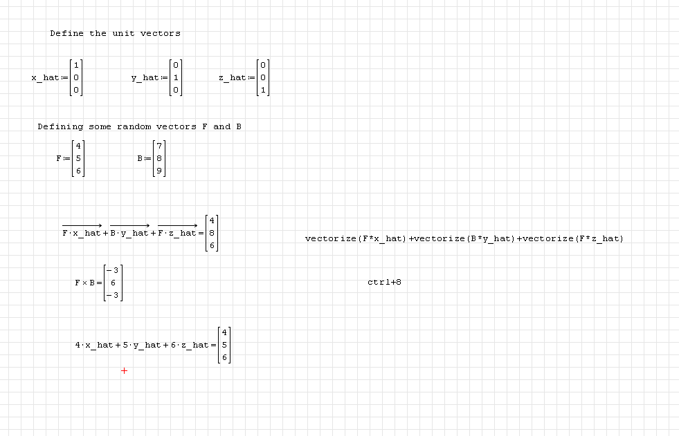

#4 Posted: 2/5/2017 6:25:50 PM
You can perform vector operations. See below. I don't think SMath has a way to put "hats" on the varaibles, but to Jean's point you can just use something from the character map. He used ALT+136 to get e_hat in his example.
