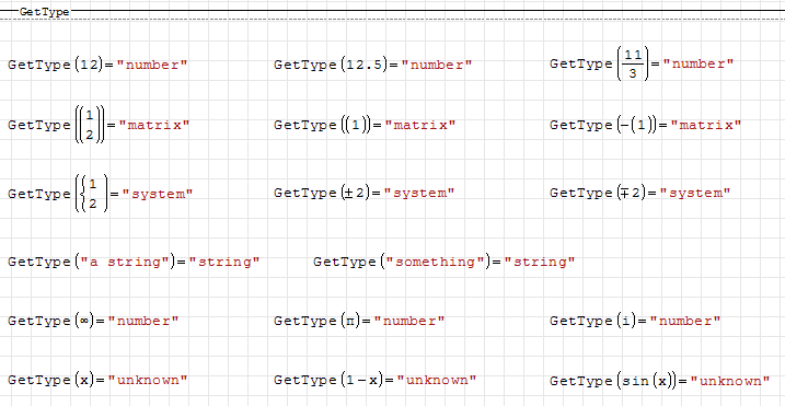

If you download the plugin Custom Functions, you can use GetType()
2016-03-23 19_57_02-SMath Studio Desktop - [CustomFunctions_examples.sm_].png

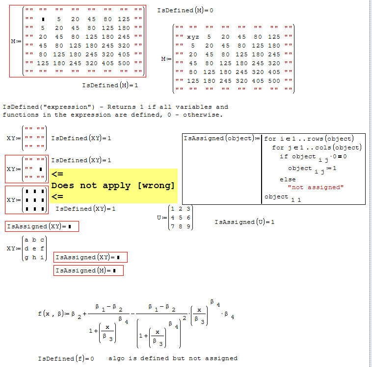

The Smath "IsDefined" works for matrices > the default .
Does not work for vector . "IsAssigned(object) would be
more inductive. Don't know how to return the last message.

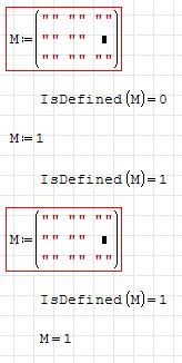

#16 Posted: 3/23/2016 7:05:04 PM
1,443 likes in 2,935 posts.
Jean,
when an error is thrown the result is not stored -> this means that in SMath Studio is not possible to define a matrix with empty placeholders -> your IsAssigned will never works under these assumptions...
Hence, also IsDefined() works correctly because the first assignment of XY is not overwritten nor deleted, hence it is still in memory (XY is defined in the worksheet memory).
BTW, you shouldn't use "object" as target of the function [el(object,i,j):whatever], you have to use a brand new matrix defined inside the function (because the pass-by-reference, if you use an argument as target of some calculation you are modifying it)
