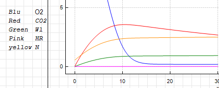

Jean, all your advice are extremely useful, I'm just exploring different ways to face this problem.
The reason for which now I'm trying the lsoda is because these are stiff equations, so theoretically lsoda should be a good way to face them.
It might be there for me a possibility to check the result, but I have to wait a bit.
For sure make all working properly will be not easy...I tried to add the microbial growth, that is related with respiration, and everything crash badly
I don't give up easily, thank to you, Viacheslav and Alvaro, I have many different ways to reach a solution, I just have to find the square.

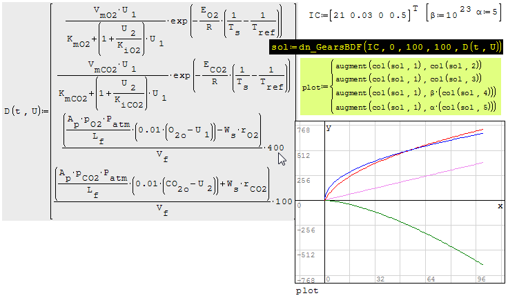

WroteJean, all your advice are extremely useful, I'm just exploring different ways to face this problem.
Fine, but native Smath ODE has all those specific solvers.
The Mathcad/Mathsoft is a very advanced ODE wrapper, all suitable to optimize
a multi-system. Revisit the early AminoHippuric, read the note ...
Dr. Wschrabi challenged Mathcad Collaboratory. In less than two days he had
1/1 his INUsoft magic solver. To me, ISODA is same topo.
1. Lab data sets ... 2. The system D(t,Y) in vector.
Each data set may each have a model function easy to fit.

Jean, Thank you again a lot for all these informations, I really need to study better the note and understand how to use it for my scope, because I have no doubt that the ODE solver has in it all the specific solvers, it is that, for now, I have some difficulty to use it. ehehe But with a little bit of time, I will be able to explore better all the things!

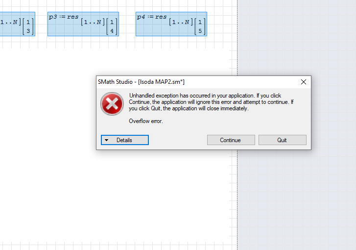

WroteYou can report about problem with lsoda plugin here. Please attach an example that reproduces the problem with your message. You also need to specify the version of the program and the version of the plugin.
But as I can see, this is an issue related to visualisation with the X-Y Plot plugin. I wonder what data led to his fall.
Viacheslav, yes I found where the problem was, an error in the variable assignations of the ODE related to the microbial growth that went to -infinite and crashed everything, now I have solved it but in any case, I attach the file in the lsoda plugin page, so you can see it.

WroteThe problem is in the X-Y Plot plugin. It cannot display the input data because it is outside the normal bounds
@ 0.037 nanometer the diameter of H atom, how many zillions years you will have
to hammer this atom down to X^-25 m in that green plot. That result is wrong from
some input coefficients/construction.

Jean your observations are all right, especially the 4! I need to be more ordered in all these works, and you haven't seen my papers works! 5 I need to learn how to do that, but export all the output in excel to have better graphs would be lovely.
And I have absolutely to try to make all the system with D(t,U) and gearsBDF!

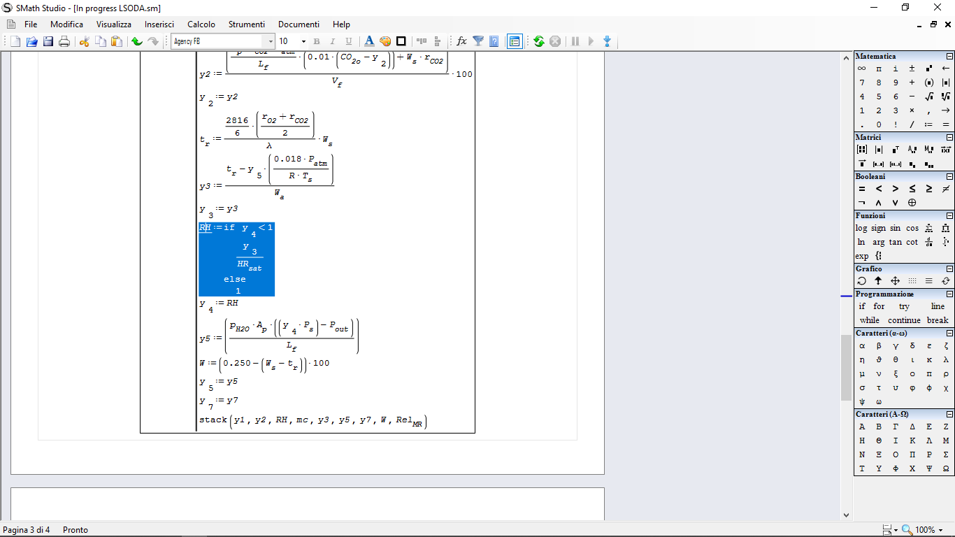

The work is still in progress, but things start to make sense.
I really don't know if my use of the "grammatic" in the system is correct or if I'm only lucky, but the results on paper are reasonable.
The "big" issue now is to make the "if" work properly, but in a way or another I will fix that problem.
I'm exploring different solutions.
As soon I will have the possibility to validate it I will put here the final work.
The model is something like a spherical horse for sure, a lot of simplifications, but I'm facing really a lot of troubles to obtaining a correct connection in the variables.
Anyway, I'm having a lot of fun.
