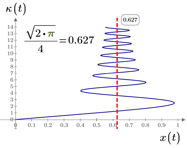

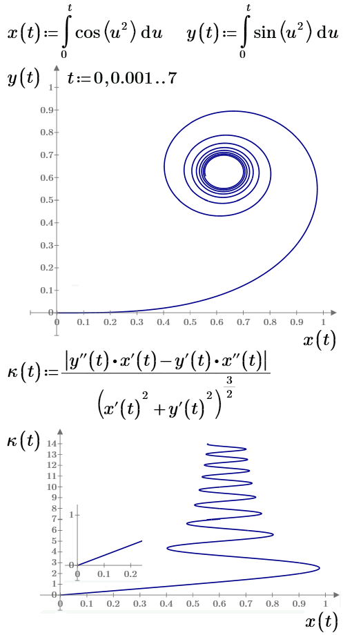

Why I can not to plot the Euler spiral curvature?
1-10-Euler-spiral.sm (175.21 KiB) downloaded 1469 time(s).
#2 Posted: 11/14/2023 4:46:11 AM

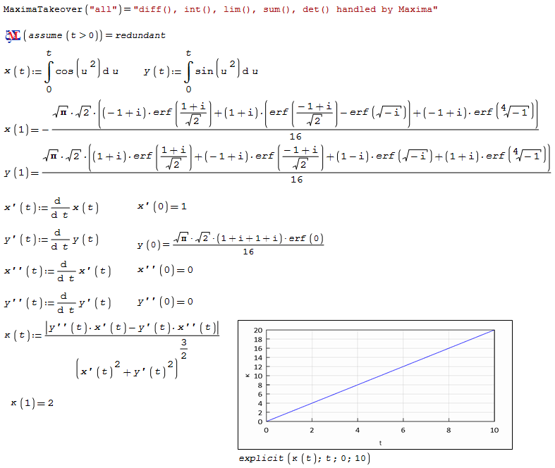

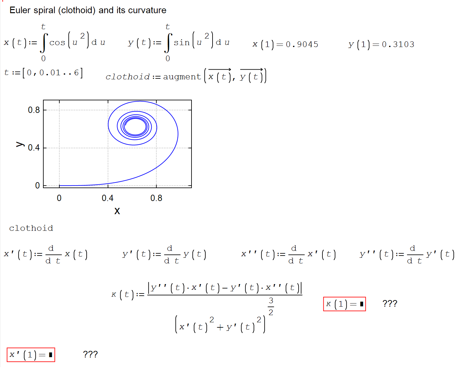

SMath native integration is a purely numerical procedure. Derivatives are symbolic ones. You would need to replace the symbolic derivatives by approximations.
Maxima can handle the derivatives. Funny enough, Maxima can't display the integral values x(t), y(t), neither can it plot them.
But you just asked for the curvature
Euler-spiral_Maxima.sm (28.89 KiB) downloaded 1437 time(s).

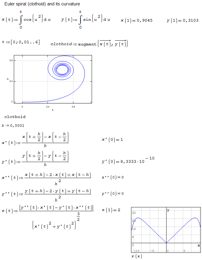

Here is a solution in pure (AKA Maxima-free) SMath.
The derivatives are replaced by difference quotients with a fixed perturbation h. Sooner or later this h is too big for a precise approximation, therefore, the value of the curvature deteriorates for large values of t.
Perhaps the fixed interval integrator also is to be blamed for the loss of precision.
Another M to patent?
Euler-spiral_Kr.sm (15.13 KiB) downloaded 1518 time(s).

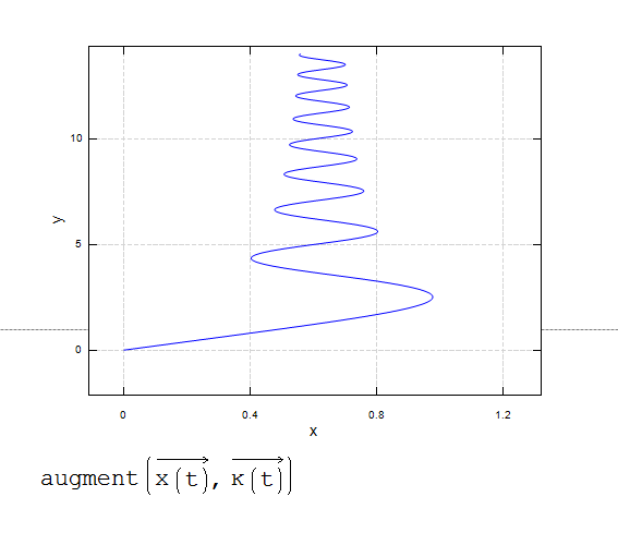

#13 Posted: 11/15/2023 10:28:26 AM

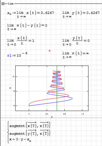

Hi. Using the numerical limit procedure from this post
1-10-Euler-spiral - option 2.sm (40.6 KiB) downloaded 1446 time(s).
Valery Ochkov 11/15/2023 12:44:00 PM

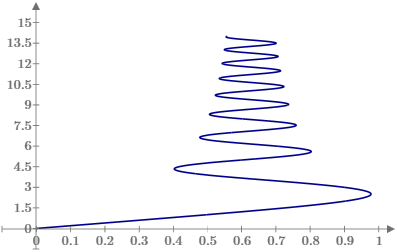

#15 Posted: 11/15/2023 10:18:36 PM
You can get that editing the file in this post:
Valery Ochkov 11/15/2023 10:59:00 PM, Martin Kraska 11/16/2023 8:17:00 AM

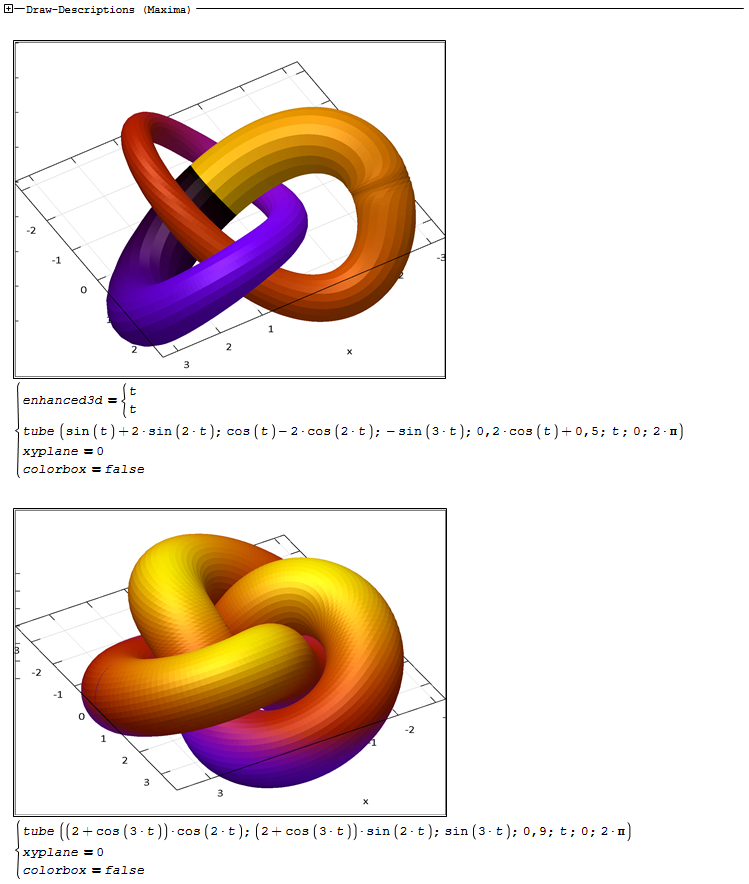

#17 Posted: 11/15/2023 11:55:45 PM

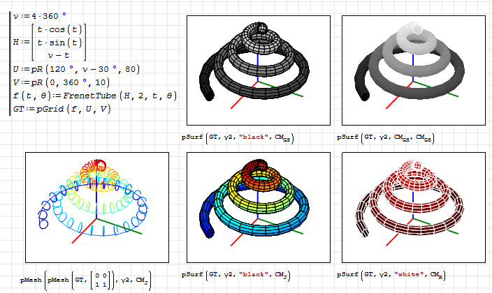

Nice picture. This is a conic helicoid.
HelliCone.sm (148.93 KiB) downloaded 1537 time(s).
Oscar Campo 11/16/2023 12:16:00 AM, Martin Kraska 11/16/2023 8:17:00 AM

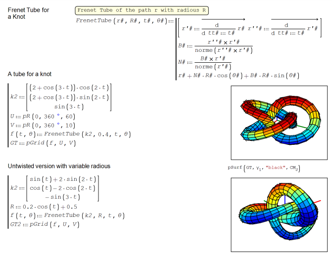

#18 Posted: 11/16/2023 8:16:36 AM
The plots are interactive (drag to rotate, Ctrl-Mousewheel to zoom). Yet, they are not really performant, takes approx. 3 seconds to update.
knots.sm (272.12 KiB) downloaded 1526 time(s).
