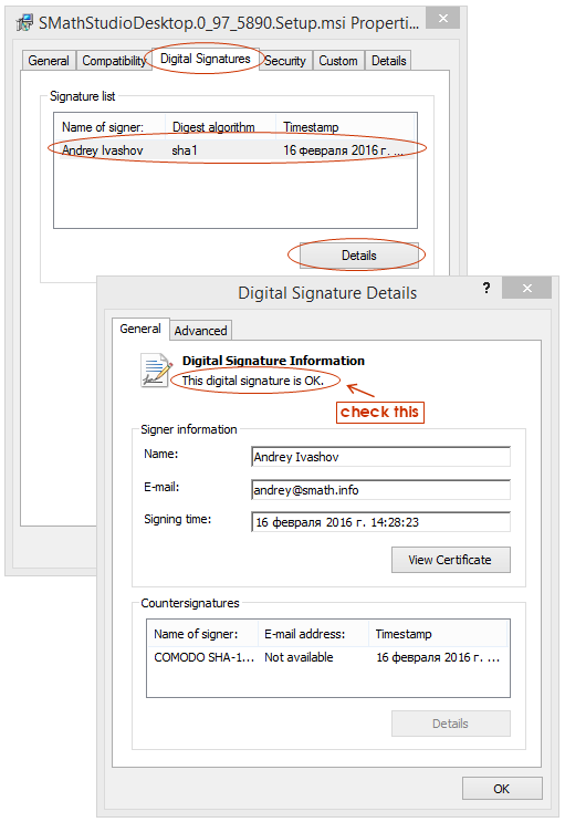

SMath Studio supports Windows 10. The error message you see can be shown by the system in case of setup package is corrupted. Meaning you downloaded broken version or, f.e. it was broken by virus on your PC or if for some reasons you downloaded only part of the file.
It is very easy to check this. Check Properties of SMathStudioDesktop.0_97_5890.Setup.msi file you have downloaded (using context menu) and check digital signature of this file like shown on the screenshot:
This is 100% guarantee that the file you have is the same as available on the official web-site.
Please let me know if it did help or not.

I check Digital Signatures is correct but I can't see more details like your second image. See below:
