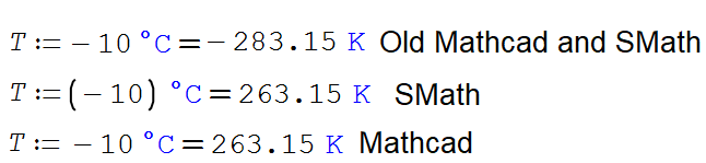

Greetings,
It is important to note that temperature is a variable unit in SMath and not a function as it is in Mathcad.
Regardless, the first line is converting 10°C --> 283.15K; and then applying the unary operator of minus (-) to the value; thus: -283.15K; Make sure you apply the unit °C to -10 and not just 10; use the space bar to group your operations correctly.
When in doubt: use parenthesis for grouping your operations.
May this be of Good Help,
- SK Kenny Lemens, P.E. ᵂᴵ

On the larger issue, I would refer you to the following handbook; it can be downloaded via your Extension Manager (i.e., [Tools] -> [Plugins...] -> [Interactive books]):
https://en.smath.com/view/interactivebook/
There is a section that reviews the Priority of operators; you will see that units are level 1, whereas unary is level 2: thus the disconnect for negative numbers.

This issue is constantly confusing new users. The evil is in the design decision that the unary minus has the same priority as the binary plus and minus, both are less than multiply and divide. This is counter-intuitive. So you have to use parentesis in SMath where you would not expect to need them with pencil and paper. Changing these priority rules might fix the problem (and perhaps cause other ones).

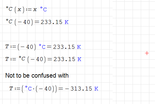

I've gotten in the habit of using this function. This is probably dumb to do, but it forces me to use parenthesis for all temps.
temperature.sm (4.71 KiB) downloaded 1633 time(s).

This is not a bug, this is how SMath works.
You have to use delta temperatures for that kind of calculations.
Unfortunately there is no easier way.
If you really need to calculate without delta temperatures,
You can use a custom equation/function like this.
