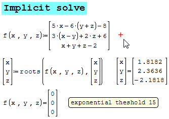

There are more ways exemplified in the attached Smath.
Setup the system in traditional format, the solving
algebra follows ... Universal. Same approach will
optimize a data set for polynomial best fit.
Cheers, Jean

#9 Posted: 8/25/2017 8:37:48 AM
Wrotewhat can be the problem??
None of the solving approach is correct.
0.5 sec visit 6179 to solve the patients.
Too big to make an image.
Solve System High accuracy.sm (115.73 KiB) downloaded 1102 time(s).
