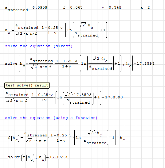

I have spent hours on solving the below equation on MathCad or Excel....however got nowhere
Can anyone please able to help me?
As you can see in the equation below, I have to plot the value of hc but its located on both right and left side of the equation. All other variable (ao, f and v etc.) are constants.
An Equation
Please help if you can.
Thank you

The equation it's not visible, could you attach a SMath file to the post?
However you can use the solve function (here there is an example for an implicit equation)

You're welcome
I attach here the SMath solution for your question.
best regards,
w3b5urf3r

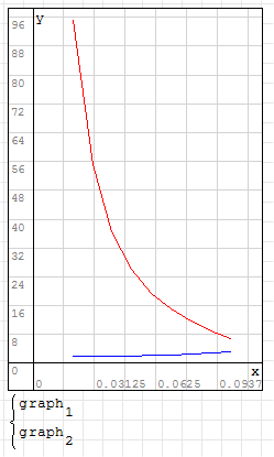

: In the above example, I assumed that hc is not a function of any other additional variable. What if, in the same equation, variable f is a function of x (like f=2x, where x range from 0 to 1 (0, 0.1, 0.2, 0.3..1). Can we then plot hc as a function of x on a graph using SMath?
Thank you for your help and please only suggest answer to my question if it does not take too much of your time. I truly appreciate your help and time.

You can do it in different ways; in the attached example I define a vector of x values (using the range() function) and then I've solved an equation for each x value with a loop and then I create the matrix to plot. Obviously if you know very well the output behavior you can do all the operations "on the fly", inside the loop.
regards,
w3b5urf3r
