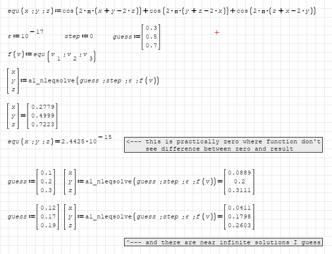

#2 Posted: 7/5/2021 10:41:14 AM
598 likes in 1,379 posts.
More experienced users may help you better than me.
But your equation seems to have infinite solutions.
al_nleqsolve equ(x,y,z).sm (10.75 KiB) downloaded 1004 time(s).
