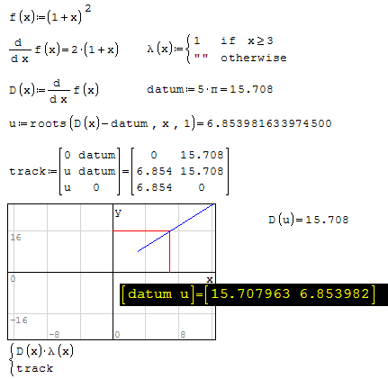

#4 Posted: 4/11/2023 9:53:17 AM
... Smath document.
Pierre.sm (7.86 KiB) downloaded 1290 time(s).

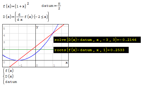

#7 Posted: 4/11/2023 12:11:44 PM
... It seems that the condition disapears after derivation.
Hi. You're using Heaviside from Statical Tools plugin. I forgot it, because I don't use it, It define Heaviside(x,y) as (1+sign(x-y))/2, which could be cool for numerical procedures, but the derivative of maple of sign(x) is zero, but diff Heaviside(x) /dx is Dirac(x). So, the file that I upload works very different with that plugin. There are also other posts in this forum about Heaviside, Dirac and civil engineering. Maxima have their own implementation of those functions too.
#8 Posted: 4/11/2023 1:12:19 PM
Your latest document is much different than your original.
The golden rule is to specify Bolean completely.
Sometimes it's immaterial ... One exception is DeBoor.

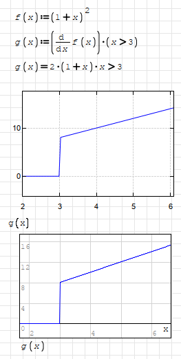

#9 Posted: 4/11/2023 6:41:37 PM
598 likes in 1,380 posts.
Hello everybody,
I have issues regarding diff function and boolean function.
I have been looking on different solution on the forum, but i have not found a related post.
How do you perform such calculation?
diff() function can't parse if original function has boolean expression.
Once derivative is completed result can be booleaned. (is this even a proper word )
Here how it is.

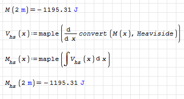

#10 Posted: 4/11/2023 7:47:54 PM
Do you have any idea on how to solve?
Yes. Use maple(diff(convert(M(x),Heaviside),x)) for convert SMath sign function into Maple Heaviside's. It looks ok now:
e7_5_3-hs ok.sm (139.5 KiB) downloaded 1331 time(s).
