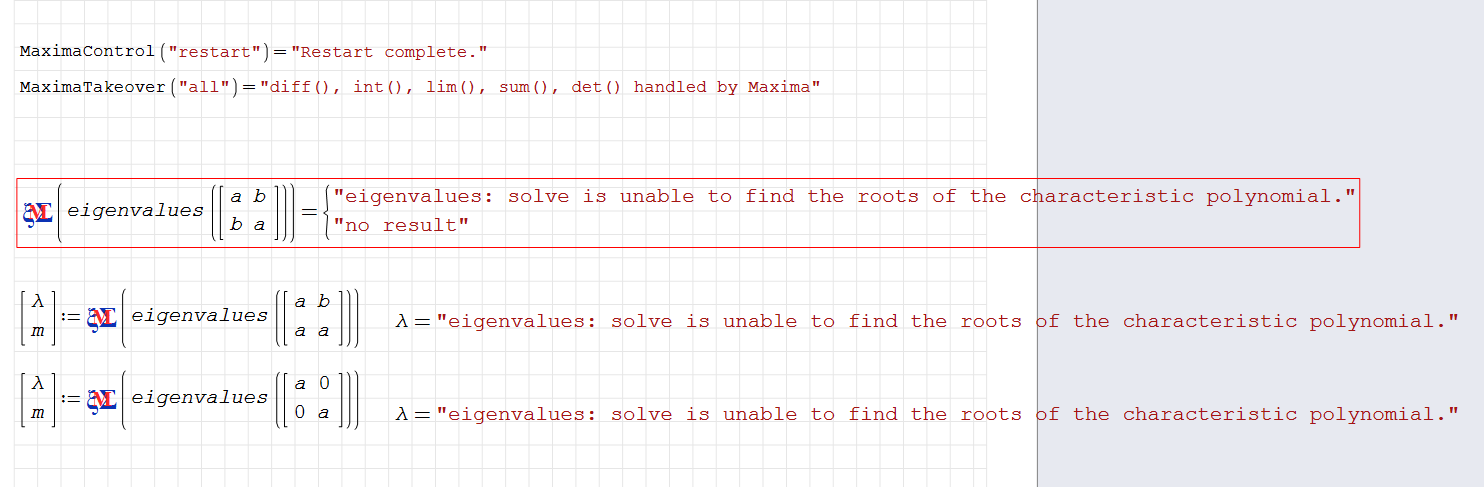

i'm studying SMath with Maxima (written by Dr. Kraska)
but i did not get the result.
my result is this.

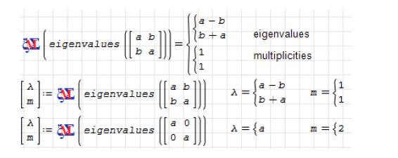

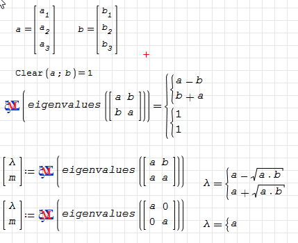

#2 Posted: 12/11/2023 11:27:17 PM
You have to clear the values of a and b. These must be scalar variables, in your sheet these are vectors.
