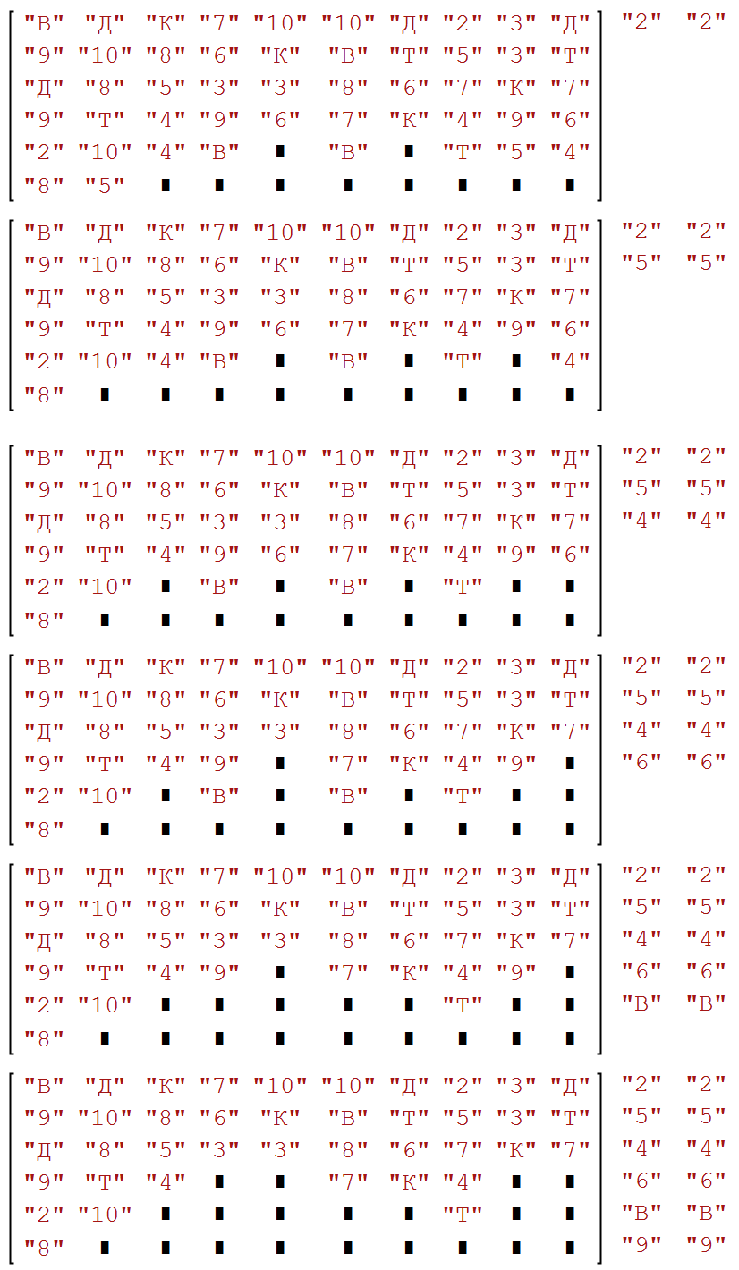

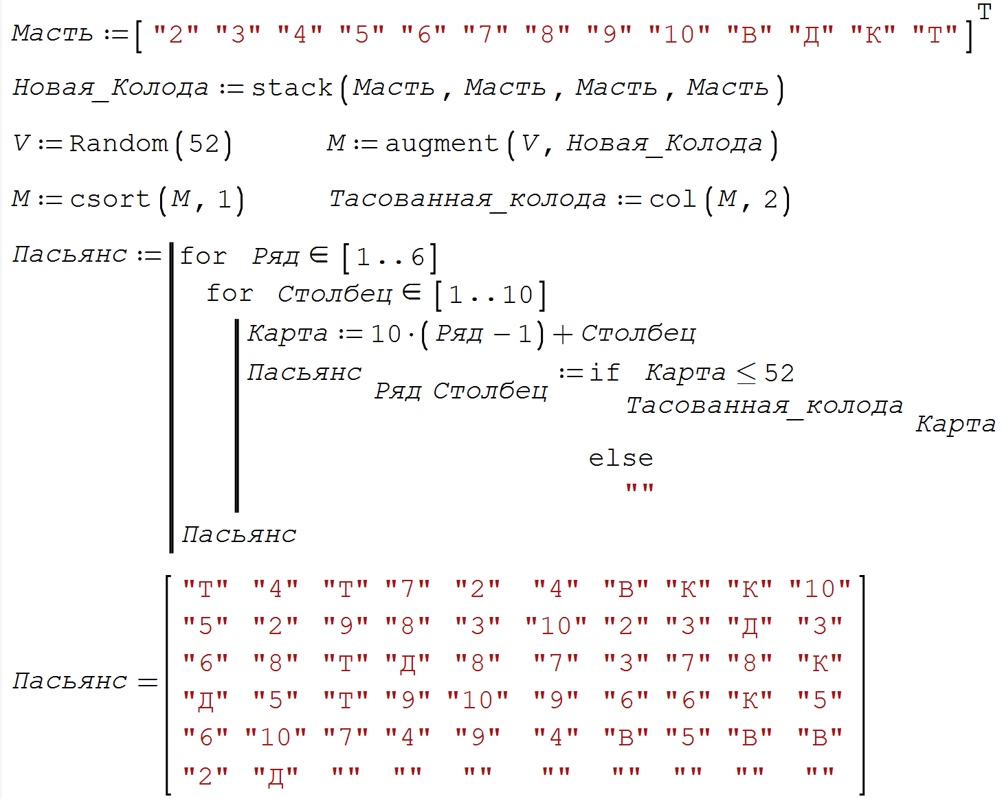

What is it with vector?
Patience.sm (37.01 KiB) downloaded 842 time(s).

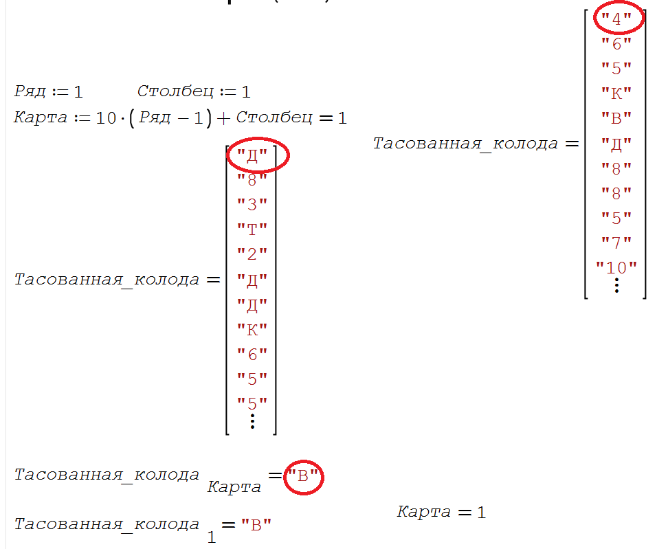

Sorry!
It is one strange bug, I think.
Without the program - all ok!
Patience.sm (37.01 KiB) downloaded 851 time(s).

I wasn't able to reproduce the error, but it appears as if the Random() function is somehow redefining your variable every time you call "Тасованная_колода" to display.

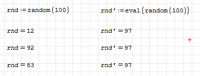

Hi. It's not a bug, but a feature. Use eval to pin up the function value.
