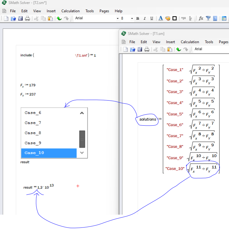

Hi all,
I am relatively new to the forum and I am trying to find a solution that
maybe was already discussed here but I was not able to find the topic.
I am trying to sort my SMath files in a way as shown in the image.
The example below is a simplified version of the real case.
I have dozens of formulas stored inside the Matrix of T1 SMath file and in other files, I use "include" to call
those formulas.
After that, I use"ComboBoxList" to choose a specific case(formula).
Regarding that everything works fine and the only thing is that I would like to be
able also to show the formula before the calculation is done.
I was trying to use the "Optimisation" options but that does not help.
Is there some other way to show formulas from imported files or maybe to organize formulas on some other logic

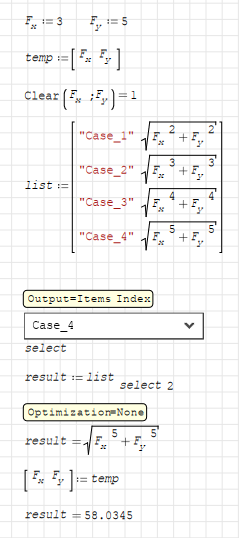

Is this a solution for your problem?
ioan92 3/10/2024 11:08:00 PM
Thanks a lot, this is exactly what I was searching for.
