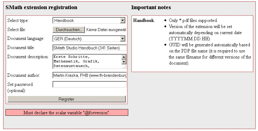

#7 Posted: 3/27/2014 1:59:38 PM
I can't provide new versions of PDF handbooks and of interactive books. In both cases, the web registration form complains that I
"Must declare the scalar variable "@forversion" "
However, there is no hint on how to specify this. I guess that this is related to the new feature for plugins, where the SMath-version can be specified, where these plugins should be offered.
Yet, the upload was successful, but the newly registered versions are not shown in the online gallery, thus not accessible for other users. Sorry for that.
#8 Posted: 3/29/2014 6:45:58 AM
Problem solved, new versions are available.
Thanks, Andrey.

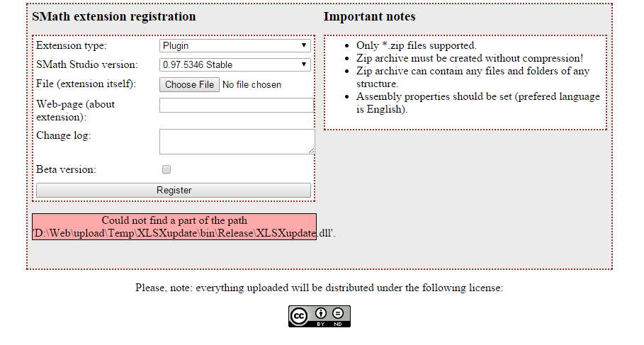

#11 Posted: 4/15/2015 9:59:51 PM
Alexander O. Melnik
Alexander O. Melnik
127 likes in 498 posts.
I Have attempted to upload a plugin and received following error. What am I doing wrong?
Thanks!

#12 Posted: 10/30/2015 2:49:05 AM
Alexander O. Melnik
Alexander O. Melnik
Hi Andrey,
I tried updating my EXCEL plugin to the extension manager with no success.It seems that things have changed, and instead with uploading zipped DLL (which was quite easy, now I need to work with "SMath Release Manager", which i am not familiar with..
Could you help me out? What do I need to do to update the .dll file to the extension manager?
Thank you
#13 Posted: 10/30/2015 9:26:10 AM
1,443 likes in 2,935 posts.
Hello oxel007
  1. Upload your project into the SVN server;
  2. Modify your *.csproj/*.vbproj to link the SMath libraries (f.e. you can look here or here);
    Important: The solution file name must be equal to folder name;
      <PropertyGroup>
        <!-- Relase -> SMath Relase Manager -->
        <SMathDir Condition=" '$(SMathDir)' == '' AND '$(Configuration)' == 'Relase' ">..\..\..\Main\SMathStudio\canvas\bin\Debug</SMathDir>
        <!-- Debug -> local use -->
        <SMathDir Condition=" '$(SMathDir)' == '' AND '$(Configuration)' == 'Debug' ">C:\Program Files (x86)\SMath Studio</SMathDir>
      </PropertyGroup>
      <PropertyGroup Condition=" '$(Configuration)|$(Platform)' == 'Debug|AnyCPU' ">
        <StartAction>Program</StartAction>
        <StartProgram>$(SMathDir)\SMathStudio_Desktop.exe</StartProgram>
      </PropertyGroup>
      <ItemGroup>
        <Reference Include="SMath.Controls">
          <HintPath>$(SMathDir)\SMath.Controls.dll</HintPath>
          <Private>False</Private>
        </Reference>
        <Reference Include="SMath.Manager">
          <HintPath>$(SMathDir)\SMath.Manager.dll</HintPath>
        </Reference>
        <Reference Include="SMath.Math.Numeric">
          <HintPath>$(SMathDir)\SMath.Math.Numeric.dll</HintPath>
        </Reference>
        <Reference Include="SMath.Math.Symbolic">
          <HintPath>$(SMathDir)\SMath.Math.Symbolic.dll</HintPath>
        </Reference>
    If your plugin uses P/Invoke to call unmanaged APIs, you have to use the AfterBuild field at the end of the file:
      <Target Name="AfterBuild">
        <Copy SourceFiles="WriterManager\Resources\Hunspellx64.dll" DestinationFolder="$(OutputPath)" ContinueOnError="false" />
        <Copy SourceFiles="WriterManager\Resources\Hunspellx86.dll" DestinationFolder="$(OutputPath)" ContinueOnError="false" />
      </Target>
  3. Use BUILD to compile your solution; a LOG file will be produced and you can notice errors and warnings, if any;
  4. Use PUBLISH to make available the plugin in the Extensions Manager;
