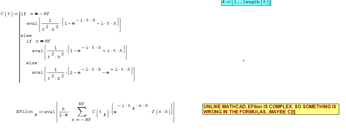

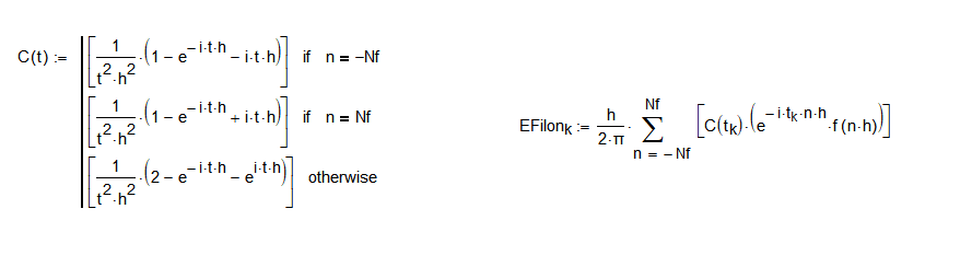

Can someone familiar with both SMATH and MATHCAD 15 tell me if these formulas are equivalent because I get very different results for each software. MATHCAD produces correct results and SMATH does not.
MATHCAD 15 Formulas:
SMATH Formulas:
Thanks for any help.

#2 Posted: 5/4/2024 7:09:11 PM
Oscar Campo
Oscar Campo
124 likes in 298 posts.
Use function cases() to define C(t)
C(t):cases(#,#,#,#,#)
[albumimg]1708[/albumimg]
