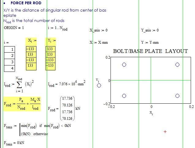

SMath Forum SMath Studio Questions Ranges, Array, and Plotting 1 Pages (2 items) Ranges, Array, and Plotting - Messages Go to last post #1 Posted: 12/19/2023 5:20:14 PM GFDIntano 0 likes in 8 posts. Group: User How do I recreate this part from my Mathcad sheet? Thanks for the help. #2 Posted: 12/20/2023 12:23:05 AM overlord 598 likes in 1,380 posts. Group: Moderator Since we are not provided P.a and M.a, I gave them temporary values.You can change them as you please. Below is your answer.Regardsboltbase.sm (9.09 KiB) downloaded 1390 time(s). 1 users liked this postDavide Carpi 12/20/2023 12:32:00 AM 1 Pages (2 items) New Posts No New Posts
