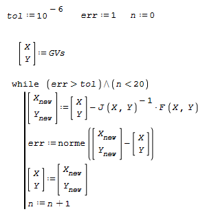

Here's a "while" version
Newton-for-1-2-3-4_b.sm (18.98 KiB) downloaded 1533 time(s).

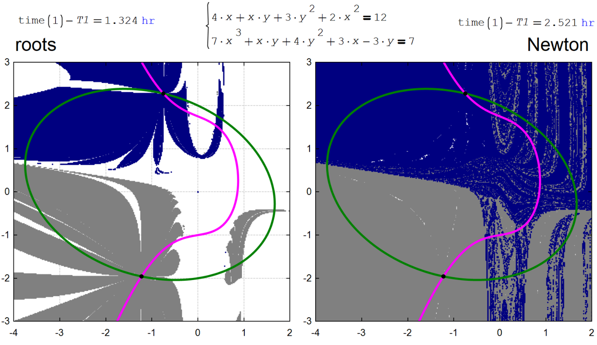

Valery Ochkov
Valery Ochkov
66 likes in 697 posts.
Roots vs Newton
#7 Posted: 2/11/2024 7:55:50 AM
oots vs Newton
No interest vs the codes
#8 Posted: 2/11/2024 1:41:06 PM
Valery Ochkov
Valery Ochkov
Roots vs Newton
https://www.mdpi.com/2227-7390/10/19/3413
#9 Posted: 2/11/2024 9:59:12 PM
roots solves Matrix.
Worksheet33.sm (6.96 KiB) downloaded 1504 time(s).

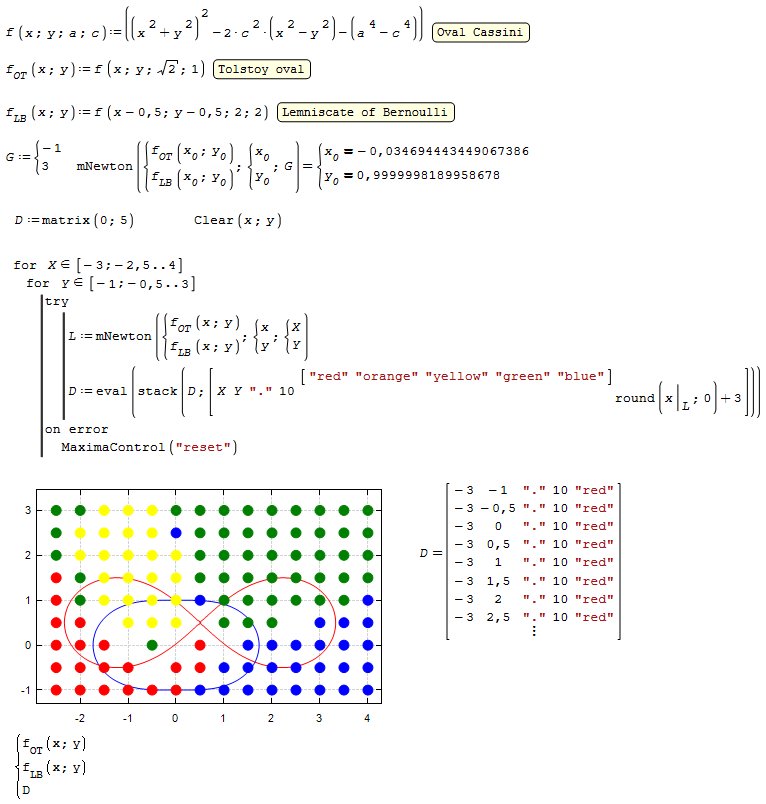

#10 Posted: 2/13/2024 6:19:59 AM
mNewton() from the Maxima plugin is another option. It also may fail for particular initial guess values.
mNewton.sm (16.22 KiB) downloaded 1583 time(s).
