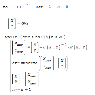

Here's a "while" version
Newton-for-1-2-3-4_b.sm (18,98 КиБ) скачан 1533 раз(а).

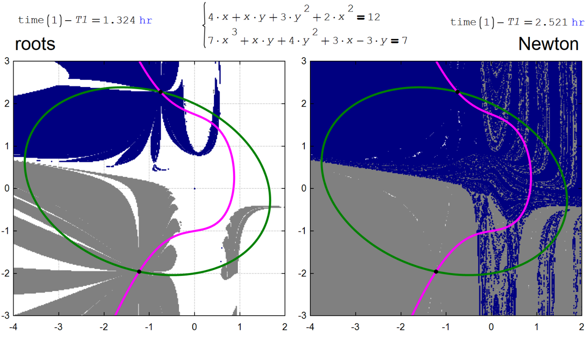

Valery Ochkov
Valery Ochkov
Roots vs Newton
#7 Опубликовано: 11.02.2024 07:55:50
oots vs Newton
No interest vs the codes
#8 Опубликовано: 11.02.2024 13:41:06
Valery Ochkov
Valery Ochkov
Roots vs Newton
https://www.mdpi.com/2227-7390/10/19/3413

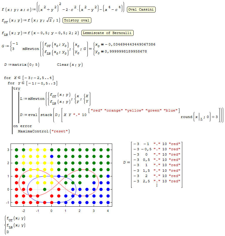

mNewton() from the Maxima plugin is another option. It also may fail for particular initial guess values.
mNewton.sm (16,22 КиБ) скачан 1582 раз(а).
