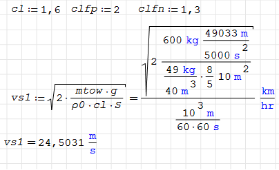

Hello, I'm trying to make a project in Smath, one of the requirements is that there must be shown what numbers am I substituting in my equtions.
I know you can change the optimalization to none to show the numbers, however this shows them as fractions and the fraction settings doesn't seem to do anything with it,
the result can be seen in image lower. What I want is to show the 49033/5000 as 9,81, which is how I defined it to begin with.
I would really apreciate if someone could tell me how to show those numbers in decimal form or how to do the whole thing in other way that would result in what I want.
Thank you very much in advance.

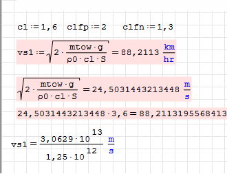

49033/5000
As you are using units, 49033/500=9.806600000000000
represents the true value of that constant in floating arithmetic.

While I'm grateful for your help, neither of your files does the thing for me. Even after reinstalling Smath,
it doesn't work.
Attached screenshot of the file from mister Giraud, file from Carlos changes nothing as well.

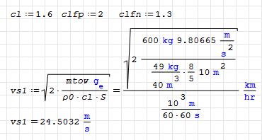

Do you want something like this?
Carlos
#10 Опубликовано: 04.03.2020 16:56:01
585 сообщений из 1 355 понравились пользователям.
you can use the pre-defined constant ge.
if you have to put user defined g constant, than I don't have any idea.

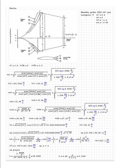

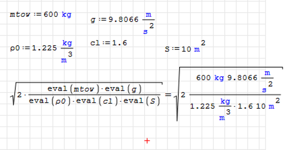

The file
Eval_Fracc_2.png,
zatizeni_R2.sm (457,85 КиБ) скачан 693 раз(а).
Carlos
#13 Опубликовано: 04.03.2020 17:46:00
Pahec97
Pahec97
Thank you very much Carlos, thats exactly what I needed.
Didn't know there even was function eval.
Really thanks.
And thanks to everyone else for helping. Incredible comunity here.
