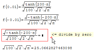

#5 Опубликовано: 04.04.2016 22:38:38

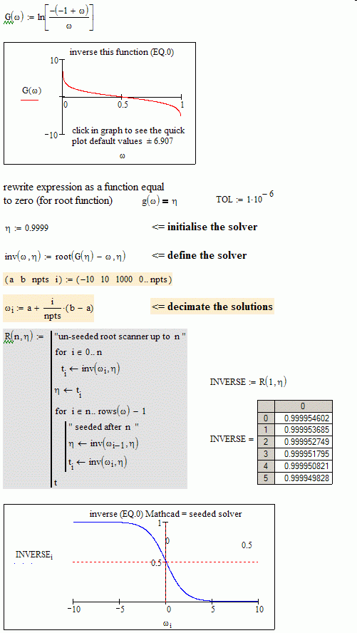

... if you don't know what is "zero money", your bank manager knows.
Not same with Smath: you still have 25.06625827963098
Enough to share a Vodka with me ?
Read carefully the last image from Mathcad: can you see what is granularity ?
Mathcad starts being granular @ much-much lower values than Smath.
Mathcad 11 was a true 64 extended floating point. Smath 5346 is 32 bits.
It does not have true floating point representation, max 15 decimals.
OK you may get symbolic fraction.

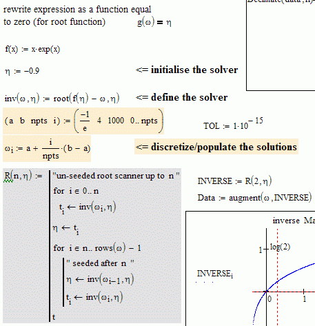

#6 Опубликовано: 04.04.2016 22:49:53
... 3 examples of the seeded root scanner..

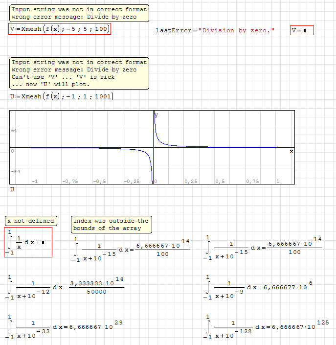

#8 Опубликовано: 04.04.2016 23:38:18
Divide by zero = infinity ? I prefer NaN
In this example, just instruct Smath to skip divide by zero.
Easy in mathcad => "on error". If you can code the "on error"
I might be able to complete the image rotation by angle.
Smath 5346 XP is 32 bits. If it would be 64 bits I would get
same result [or about same] than Mathcad 11. Just calculate
the example in the Granularity.sm @ the same values than Mathcad.

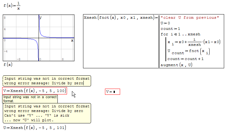

Smath quick plot manages to plot 1/x. For discrete tasks: NOT
unless you manage to escape the zero.
#9 Опубликовано: 04.04.2016 23:54:16
Mike Kaganski
Mike Kaganski
Just curious: why do you need "count" when it's equal to "i"?
That's the very idea I talk about. But here, the infinity is ccorrect answer. You may test if it's infinity, if you please.
That SMath is 32-bit at your computer, it's normal. It's not Mathcad, so don't try to convince everybody that it must always behave just like Mathcad. Only if its results are wrong (taking into account its current bitness), and only if you use current version, it's correct to argue that SMath should improve here. Using outdated version isn't good, because you declare problems that could well be fixed already.
The "wrong error message" is actually somewhat correct. SMath takes passed function, tries to execute it with an argument, and gets error. It doesn't propagate the exact error from the function to you, (which is a pity), but instead informs you, that an argument (input to function) wasn't correct.
Though I would prefer it to say something like this:
"fnct(0): the input is incorrect: Division by zero".
С уважением, Михаил Каганский

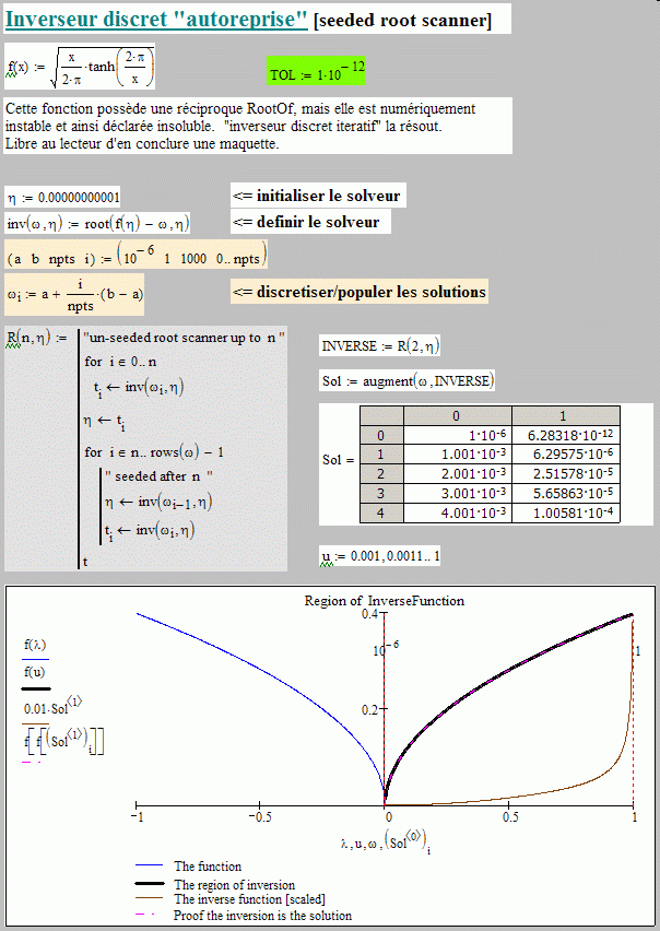

#12 Опубликовано: 05.04.2016 00:41:20
... in the attached, I have added some "kitchen work"
I don't understand "PC gaming company" ?
Do you mean company designing 'kids games' ?
Not so long ago for games on ordinary PC Windows
they disabled the floating point. How many Mathsoft
Collabs had this problem after their kids 100's + 100's.
Easy to repair: run "RegTool", to register back the FPU.
Cheers, Jean => bed time.
Untitled Granularity.sm (56,2 КиБ) скачан 1550 раз(а).

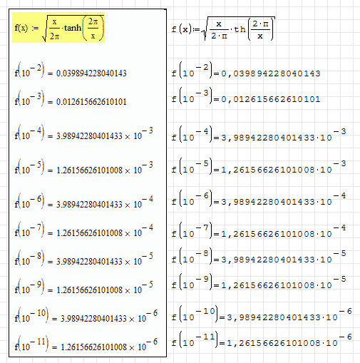

#13 Опубликовано: 05.04.2016 01:25:58
Mike Kaganski
Mike Kaganski
Here goes current SMath on 64-bit hardware.
The error message is "fixed" - if I understand your concern properly. If only it could do what I ask for - there wouldn't be that error in the first place.
The first integral isn't calculated. But that's outside of this proposal's scope.
Others calculate properly.
sqrt(-th(-73*π)) gives 1, as well as sqrt(th(114*π)).
q(0.01) gives 0.039894.
Maybe it's time to update?
