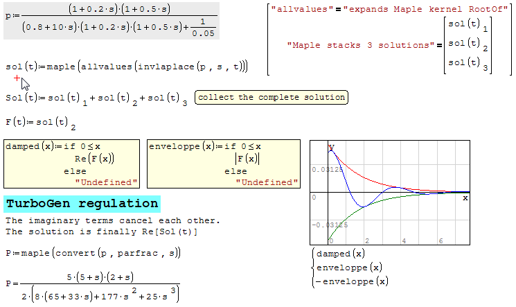

#1 Опубликовано: 28.04.2024 12:37:36
Valery Ochkov
Valery Ochkov
Lens.sm (118 КиБ) скачан 1644 раз(а).
Thanks to StvMath

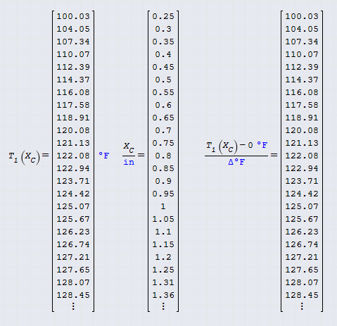

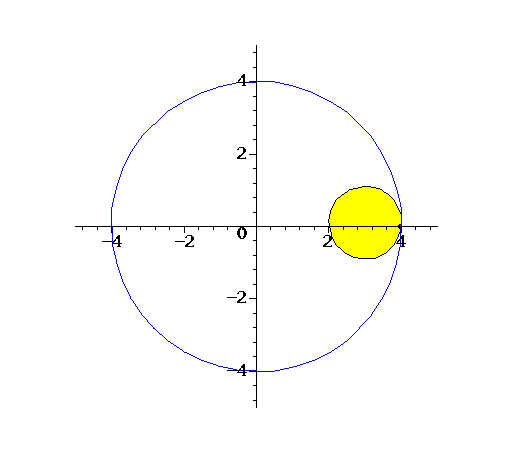

#2 Опубликовано: 04.05.2024 06:15:53
Nice example!
Slightly modified using y_c = r (doesn't work with roots())
Lens.sm (120,4 КиБ) скачан 1636 раз(а).
