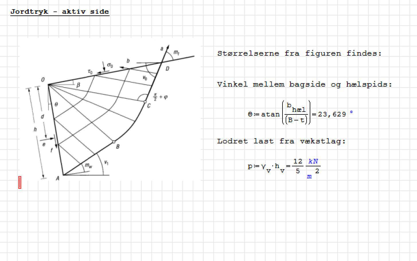

I have done a calculation on a retaining wall, which suddenly has become corrupted. Smath will open the file, but won't display most of it. The last pages are missing, and there is just a red error dot on the last page (see pic)
Показать спойлер
Stottemur.sm (491,35 КиБ) скачан 1337 раз(а).. Is it somehow possible to restore this?

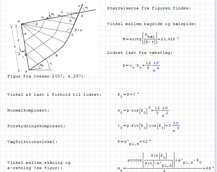

Here you are:
Stottemur_Kr.sm (491,24 КиБ) скачан 1305 раз(а).
#3 Опубликовано: 15.05.2017 17:17:39
sdfms
sdfms
That is amazing, thank you so much, you really saved me a lot of time there!
