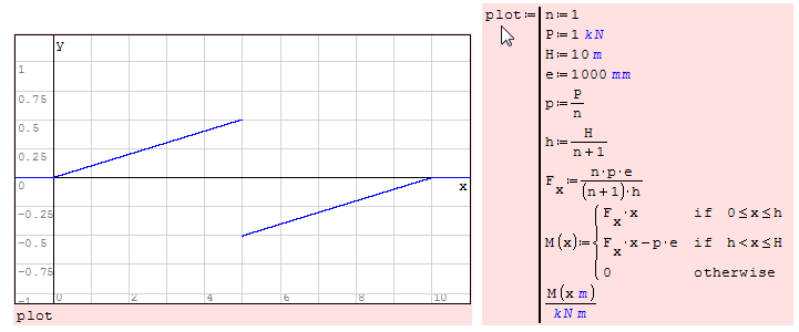

I have come across an obstacle that I have not managed to find a satisfactory solution to. I am sure the problem is easy for the experts here, but the solution completely eludes me.
I want to make a function to plot bending moments caused by an eccentric load.
My aim is to make an equation/function that can plot a continuous bending moment diagram, while being able to scale how many loads is acting on the member.
Thank you for your time.

Hi Jean,
I want a function that will represent M(x) where the eccentric load P will be divided into n equal loads which are spaced out evenly along the length of the member.
Does that make sense?

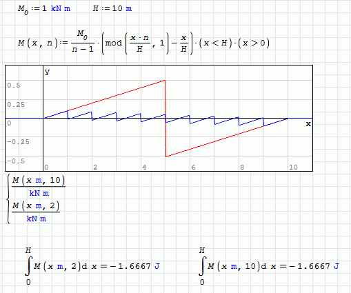

WroteNow with proper scaling
saw1.sm (5,15 КиБ) скачан 1107 раз(а).
Thank you Martin, this is exactly what I am looking for!

The approach was purely phenomenological, i.e. to reproduce the plots, no matter what they mean. The idea was to combine a sawtooth function and a linear term (slope). There are many options to get a sawtooth, the modulo function being just one of them. Others are round(), Floor(), Ceil()... The remainder was guessing the coefficients in a heuristic trial and error fashion.

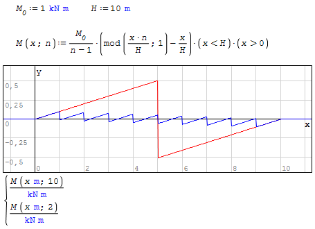

WroteWroteNow with proper scaling
Just for show why the Martin solution it's correct:

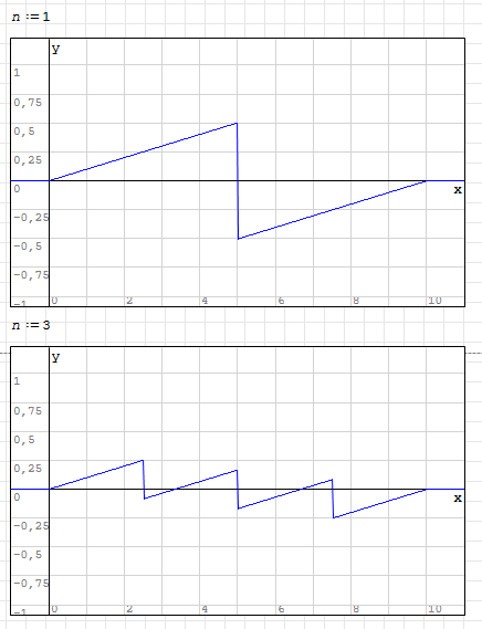

Interessting. I have tweaked Martins equations - now n represents the number of loads, not the number of segments between loads/supports.

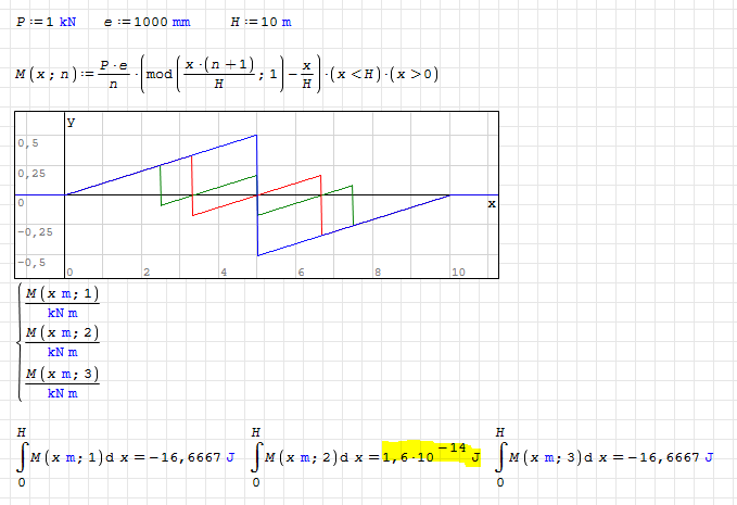

Any idea why the integral gives me this result? Also, my integral is 10x the value of yours.

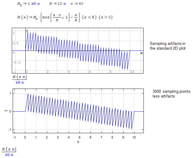

I thought that might be the case.. Anyways, it was purely to illustrate what happens when n approaches infinity, and your solution worked wonders for that!
Thanks again
WroteAny idea why the integral gives me this result?
Smath native Simpson integrator ranges from:
1. Exact only few trivial cases.
2. Acceptable but depending upon Options/Calculations/Int. acc
set 1000 in your example.
3. Native Simpson may be TOTALLY useless.
Sooner or later, units system collide in the wall.
Discontinuous integration is poison in the soup.
Master tool box has done all difficult projects
