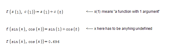

#2 Опубликовано: 07.07.2021 08:32:56
Yes it is possible, see the attached image

#3 Опубликовано: 07.07.2021 09:31:23
Paweł Wierzba
Paweł Wierzba
Thank you very much. Indeed, it works, even with functions with more arguments than one.

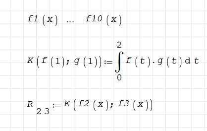

#5 Опубликовано: 07.07.2021 10:11:06
Paweł Wierzba
Paweł Wierzba
Thank you for the advice. Fortunately, standard way of defining functions is well known to me.
Unfortunately, I had to pass functions as arguments, rather than define them the "standard way".
I had several functions and some coefficients to be calculated, based on them.
Something like the example below.
If done the standard way, it would involve a LOT of writing.

#7 Опубликовано: 07.07.2021 13:23:49
Laurent Fournier
Laurent Fournier
9 сообщений из 66 понравились пользователям.
Beautiful!
I wonder why Jean is not so enthousiastic?

#10 Опубликовано: 07.07.2021 15:22:21

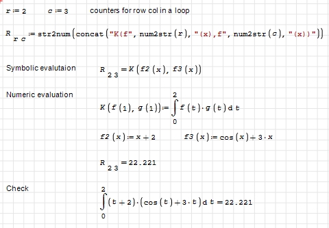

Hi. You can try a for loop with something like this in the body
#11 Опубликовано: 07.07.2021 15:31:59
Make it algo style as exemplified.
At this point, you are missing a link ... what link ?
Before integration, you must plot the integrand.
That will avoid the Simpson integrator to result scrap.
Visit/search 'Samples' for more integrators [Adaptive, Romberg].

#16 Опубликовано: 08.07.2021 09:45:19
Thank you for help, especially the comment about potential problems
with the integrator and illustrative examples.

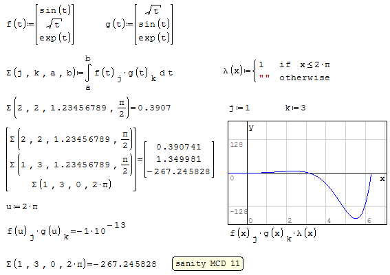

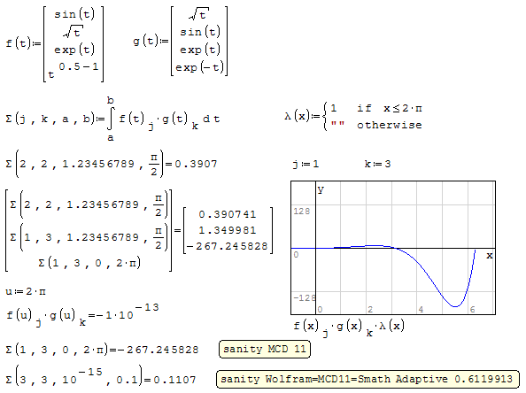

I posted the wrong image ... that's the right one.
Don't drop dead by how far simple integration can fly in the blue !

1. The previous image as *,sm
2. My Integration tool box.
Please, don't hesitate for + ... Jean
Integral 000000000000 vectorsf(j,k,a,b).sm (13,15 КиБ) скачан 1650 раз(а).
Integral 00000000 MASTER ToolBox.sm (477,13 КиБ) скачан 1669 раз(а).

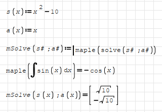

#18 Опубликовано: 08.07.2021 16:25:50

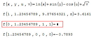

Looks like line() mysteriously solve the issue.
I have come across similar to this behavior before.

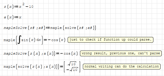

#19 Опубликовано: 08.07.2021 17:21:01
Hi. For help understanding what's happen: that behavior is similar to the SetDelayed in Wolfram Mathematica language: https://www.wolfram.com/language/elementary-introduction/2nd-ed/39-immediate-and-delayed-values.html
