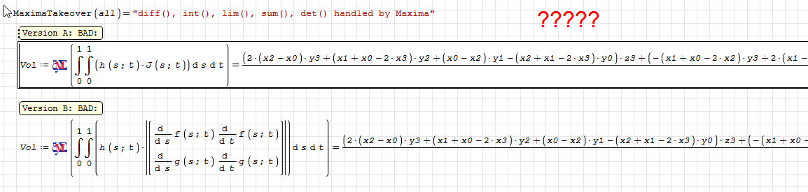

Hello Everybody,
I need your help for a subject concerning the « Maxima » plugin.
Of course, my first call is to Martin, the creator and the promoter of this plugin.
Like many others, I used Maxima often and with enough success. Recently, I’ve used it for some triple integrals, with good results.
For the case I included in the appended file,
Maxima Integration Problem - Ioan - 25032026.sm (292,12 КиБ) скачан 637 раз(а).
I need a double integral for functions composed of two functions, defined outside the integral formula.
The Maxima plugin fails the job.
But, when I include the explicit definitions of my composed function inside the integral line, everything works fine. I think that behavior is something that could be avoided.
Normally, I do not exclude a wrong use in my application.
Thanks for your attention and for help,
Ioan

Did you just forget to redirect the calculus functions to Maxima? Or did I miss something?

That's it! Thank you a lot!
