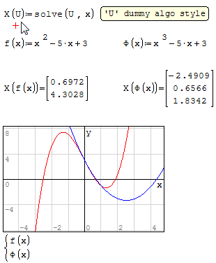

Useful for collecting multiple sets of solutions.
Solve Algo Style.sm (4,97 КиБ) скачан 1117 раз(а).

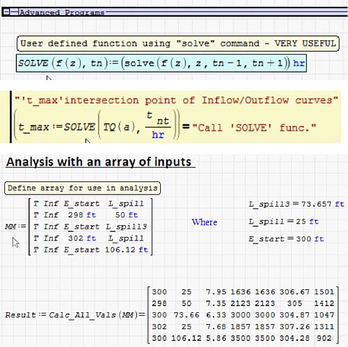

A similar approach used in the attached example.
Small Dams Flood Routing Ex-Program Method-Original-Simple3-R4.sm (1,3 МиБ) скачан 1248 раз(а).
Thanks Collab, great project
Page2 NDTMA.sm (88,72 КиБ) скачан 1387 раз(а).
