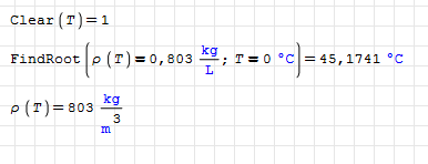

How to solve the equation with units?

Maxima won't help because procedures aren't translated. In the given case, you could just switch x and y vectors in the interpolation to directly get T(rho).
