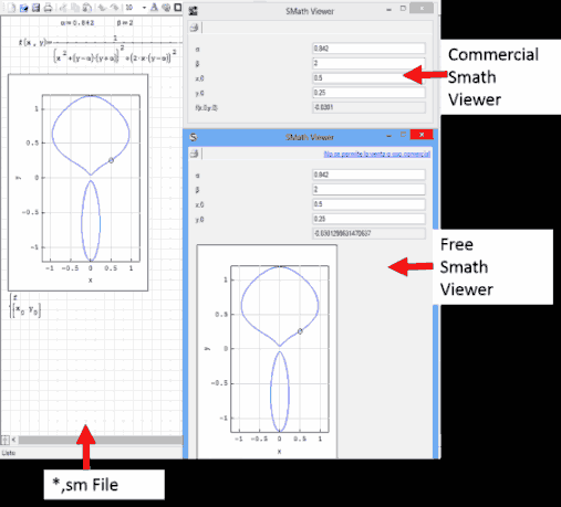

I understand your point: Commercial Viewer does NOT capture the plot.

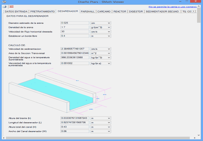

I explain how I see the use of Smath Viewer.
A program was developed to calculate or design something , in order that almost anyone can use it with minimal knowledge.
The person using it , simply by changing the input data , this can calculate or design element in smaller or larger size .
The person does not see the formulas or source code . Then Smath Viewer is ideal to be used by almost anyone .

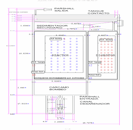

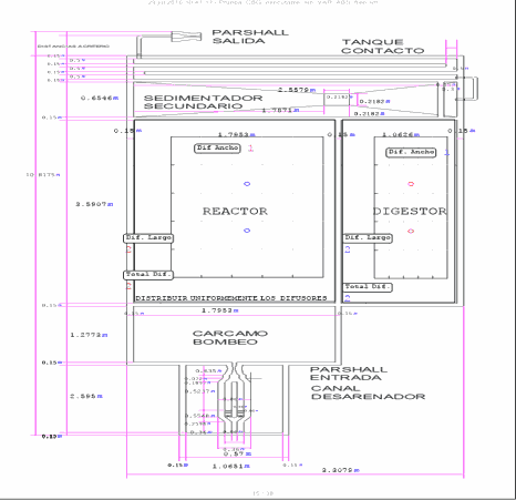

In my case, I am trying to develop a program to calculate and design Wastewater treatment Activated Sludge fine bubbles Plants .
The graphical X -Y plot , use it to graphically display the distribution of air diffusers .
Some screenshots
Small Plant (two diffusers).
A slightly larger plant (60 and 48 diffusers)

WroteCommercial Smath Viewer does not display the graphical X -Y Plot
This is because SMath Viewer Pro doesn't support third-party plug-ins (because of technical challenges). I'm working on it...
Andrey
Thanks for your reply-
But I have curious to know , because the free version of Smath Viewer does support the Plugin X -Y Plot, and PRO version does not , if it is assumed that the PRO version has more features .
Carlos
Carlos
You are right. But the reason of why SMath Viewer Pro costs nothing is that it is not actually ready yet.
It will support third-party plug-ins when I will implement it.
