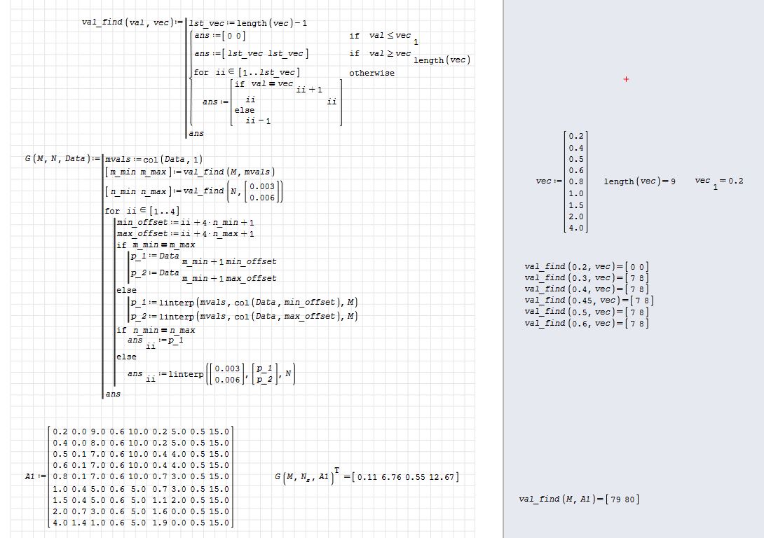

I've have a loop interpolating and searching for values. I not sure what went wrong, the loop is suppose to return 4 answer, however I am only getting (1), the last value.
Appreaciate some help and guidane.

#3 Опубликовано: 27.01.2021 21:48:48
Page7.sm (45,9 КиБ) скачан 1299 раз(а).
Below you can find corrected file.
I have revised some equations in var_file() and G().
They were trying to reach out of matrix.
Since I don't have original mathcad file this is best I can do.
I did some error check but maybe you have to dig further.

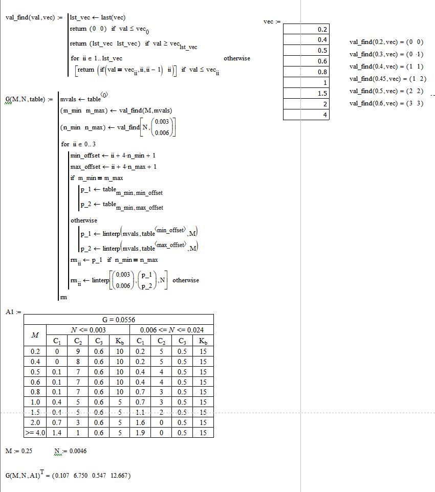

#4 Опубликовано: 28.01.2021 07:54:46
Tow Wai Lim
Tow Wai Lim
0 сообщений из 42 понравились пользователям.
Hi Overlord,
Thanks for the reply. Although the val_file() is not returning the same answer as per the attached MathCAD but the overall loop actual works.
See attached calculation in mathcad.
Page 7.xmcd (97,02 КиБ) скачан 1379 раз(а).
#5 Опубликовано: 28.01.2021 09:23:25
Hi Overlord,
Hi. val_find() returns the vector index, so it must to be the mathcad answer plus one, because ORIGIN:=0 in mathcad.
val_find.sm (134,2 КиБ) скачан 1158 раз(а).

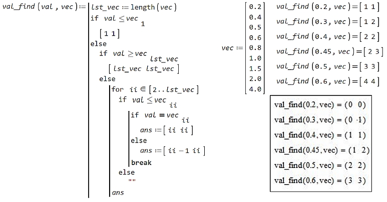

Page19 Search_Locate.sm (369,34 КиБ) скачан 1082 раз(а).
Tow Wai Lim 28.01.2021 10:50:00
#7 Опубликовано: 28.01.2021 10:48:40
Tow Wai Lim
Tow Wai Lim
Thanks Alvaro for your comment.
Jean, that is cool stuff... you can draw something like this in the SMath...

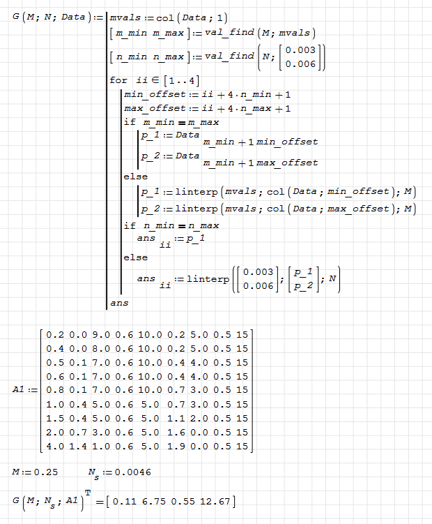

#8 Опубликовано: 28.01.2021 10:54:19
Hi Overlord,
Having the mathcad file revealed the difference of two programs.
The problem is n_min and n_max in smath version.
Mathcad assigns them [0 0], [0 1] and [1 1] only, whatever you enter.
min_offset and max_offset can be calculated within bounds of 9x9 matrix by them.
By that, offsets are always lower then 9 during max_offset=ii*n_max+1.
Your current smath function will produce out of matrix.
Because n_min and n_max are [1 1], [1 2] and [2 2].
And by adding ii to them it will be bigger than 9.
Algorithm should be revised with respect to that.
n_min and n_max should be lowered by 1 to correct it.
You can find re-revised file according to this.
If anything is unusual you can tell, we will try to fix it.
Page7_re-revised.sm (47,13 КиБ) скачан 1293 раз(а).
