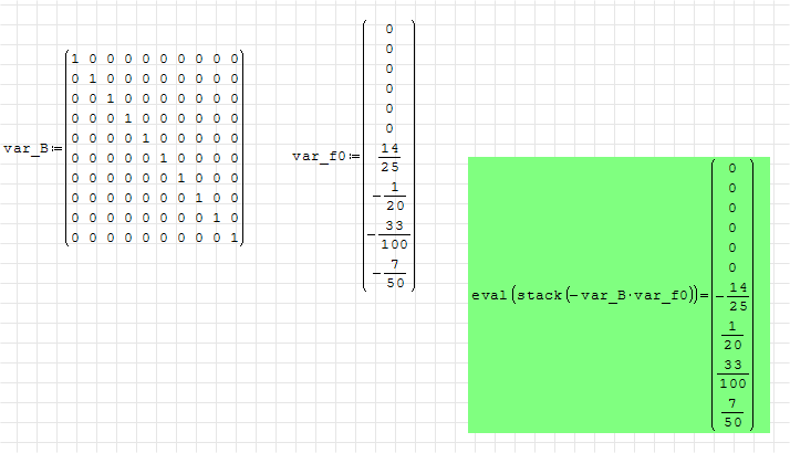

Here there is a file made with SMath 0.95 (1st screenshot) by omorr; the example show the bug directly (no needs to open a couple of files) in the root() function (SMath 0.96.4884 - 2nd screenshot) but I've noticed the same issue trying solving this problem using my Nonlinear Solvers, so I suppose it's something deep outside the root() code...

After a little "debug session" using the Nonlinear Solvers Broyden() function as reference, seems that the issue is related to the eval function ...
I attach here a screenshot of the code.. at the first loop the variables are those shown in the 2nd screenshot; the stack function doesn't cause issues, but enabling/disabling the eval the error disappear (at least for this piece of code)...
Hope this will be useful for Andrey

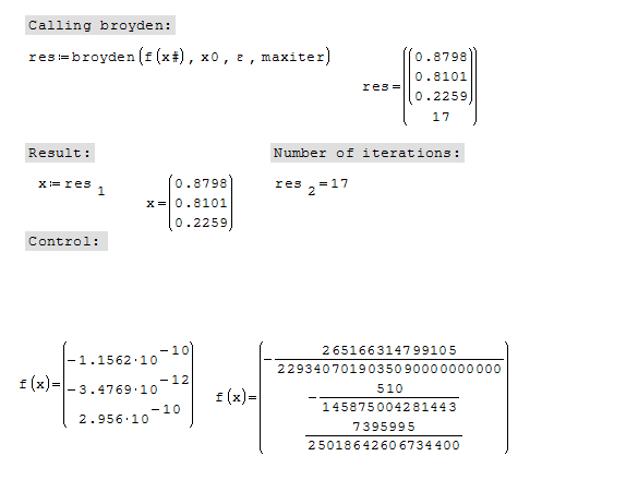

Now, function call will work and the results will be obtained. But, strangely, you can not get the numerical values of the function f(), only symbolical - see the first picture please.
Save the corrected ( broyden-method.sm )and close SMath. Reopen SMath and open just ( broyden-method.sm ). Now, everyrhing is fine (the second picture)
