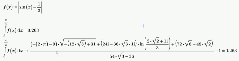

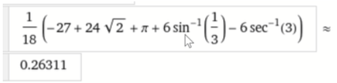

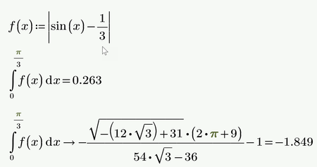

Why SMath studio does not give at least the correct result which is 0.263 for this integral?
Mathcad Prime 10:
-1.849 result is comming from symbolic result calculation, which is wrong in this case, but numeric result 0.263 is correct here also in mathcad prime 10.
Mathcad Prime 6:
SMath Studio:
Wolfram mathematica:

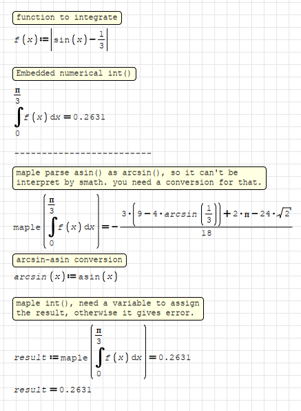

You must clear previous results (implicit definitions). If you do not, the task statement may change. To be sure, do each check separately in a new document.
maple-int-arcsin.sm (7,66 КиБ) скачан 1522 раз(а).
#4 Опубликовано: 14.10.2024 18:47:14
It gives correct results, even with embedded or maple.
You need to change arcsin() function to asin() however.

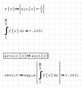

Could you post also the worksheet? As I do not know why my function arcsin(x) definition is not taken into account

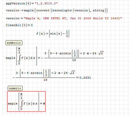

There may be different regional settings here. What you see as a plugin error is not always a plugin error. It may be an error in interpreting the results from the plugin or an error in the program itself. A little investigation is needed to clarify the details of the crime.
Here it is, regards
int-embedded_maple.sm (6,97 КиБ) скачан 1511 раз(а).

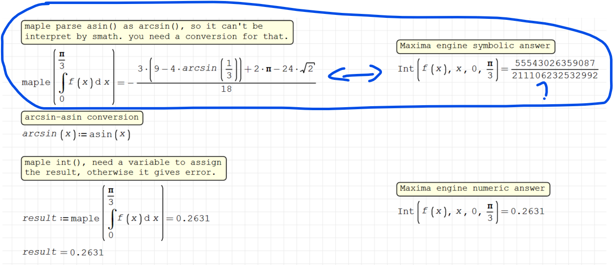

I see also the difference between Maxima engine and maple version 6 engine (in symbolic answer). With maxima engine the result is more a rational approximation of an irrational result. I would expected something similar as maple engine give when evaluating integral symbolically.

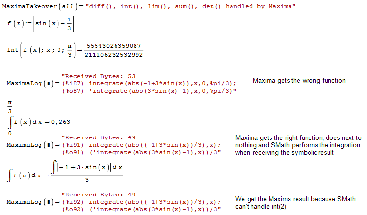

#13 Опубликовано: 15.10.2024 16:00:37

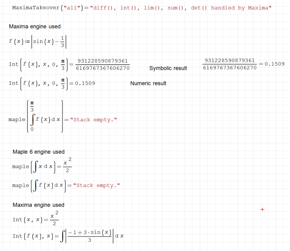

Maxima can't handle the integral. It returns a slightly modified symbolic representation. This is hidden by SMath postprocessing of the symbolic results (which doesn't seem to be suppressed for Optimization> None.
There seems to be a problem in preprocessing/translation when using the Int() function.
Worksheet20.sm (7,27 КиБ) скачан 1475 раз(а).
#14 Опубликовано: 15.10.2024 18:58:07
There is a load("abs_integrate)$ statement for these kind of situations.
If not used, maxima can't parse absolute integrals as I have understood.
https://maxima.sourceforge.io/docs/manual/de/maxima_181.html
It doesn't work on my linux commandline maxima however.
Possibly missing the module.
