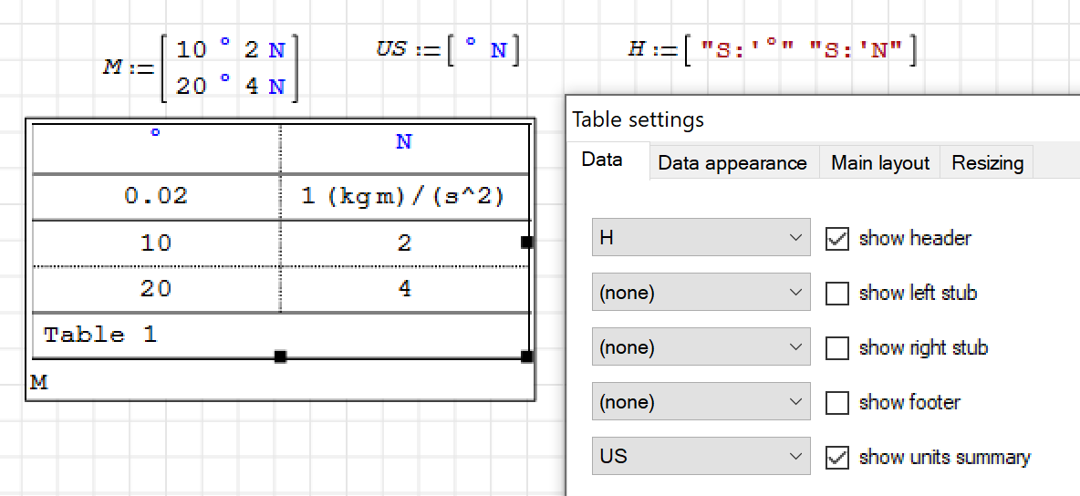

Just wondering if anyone has a workaround or knows how to change the units of a matrix with text in some slots of the matrix.
I understand a matrix with text and units will display all items as default units, is there any way to change them?
Thanks in advance.
You have to extract submatrices and display those separately.
The table region provides some extended options. There you can specify column or row units but you have to write them explicitly to the header if you want a nice display of column units.
This is sort of redundant and therefore error-prone input.
table.sm (7,87 КиБ) скачан 1367 раз(а).

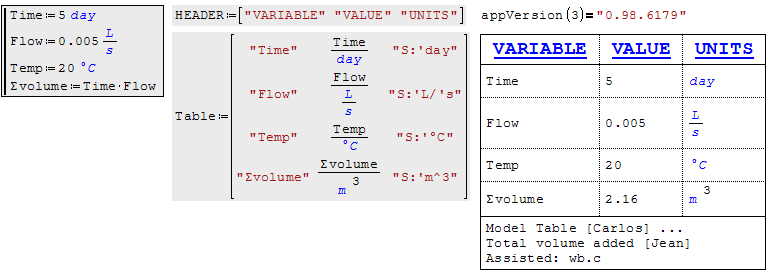

Is there any way to fix the improper positioning of text (which start with "S:') when used in tables?
Misalignment is so obvious, blue colored special text is always a bit upper in tables than the rest as it can be seen at this example too.
WroteWroteIs there any way to fix the improper positioning of text (which start with "S:' when used in tables?
What's wrong with such perfect Table ?
What Jean says is: Stick with build 6179. The problem is version-dependent. The new text engine has multiple alignment problems, not only vertical but also horizontal (long words in text tend to overlap). It is just an intermediate step towards extended functionality. Using the newest version and reporting problems can be understood as a way to support the project and pay for use of free software.
WroteWhat Jean says is: Stick with build 6179. The problem is version-dependent. The new text engine has multiple alignment problems, not only vertical but also horizontal (long words in text tend to overlap). It is just an intermediate step towards extended functionality. Using the newest version and reporting problems can be understood as a way to support the project and pay for use of free software.
Thanks, didn't know the text engine generates different behavior between versions.
I don't bother this issue that much and don't complain actually.
Just wanted to know the reason and learned.
